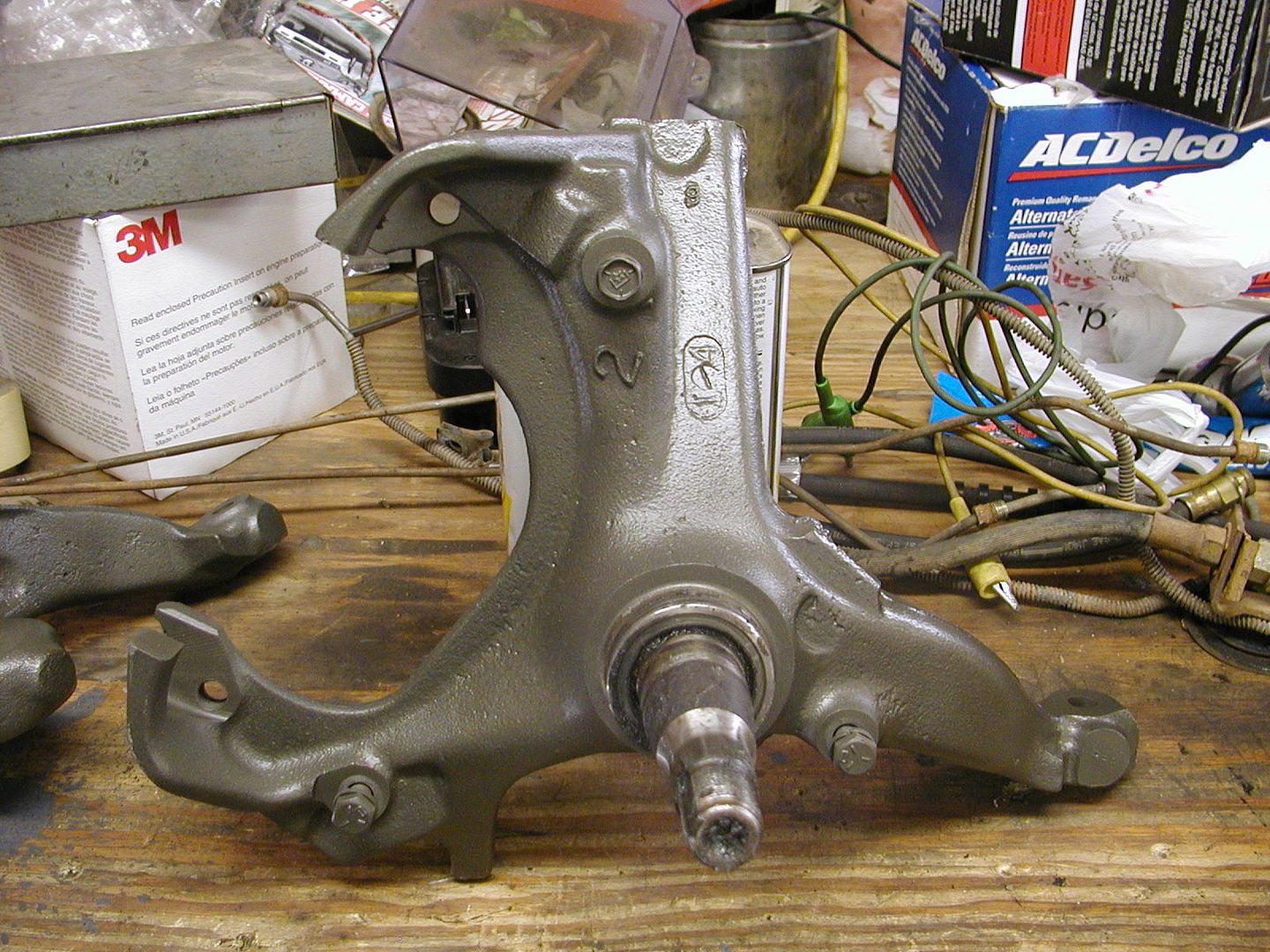

vs
4thgens have bolt-on hub/bearing and an upper control arm where as thirdgens have no upper control arm (spindle bolts directly to strut) and serviceable inner and outer bearing setup.

No, they don't bolt on the same. As Paul said you'd need to drill/tap the dust shield holes for something larger (usually 3/8,10 or 12mm) and bolt on an adapter bracket. Then you can just bolt on a 4thgen, c4,c5,c6, ctsv, zr1 etc caliper/abutment bracket or whatever you want.

Grab a spare set of spindles from the JY and start hacking.
Here, use this;
PostPosted: Wed Sep 22, 2010 9:27 pm    Post subject: Reply with quote
Here, use this;
After making the cut on the dotted line above, your spindles should look something like this...
Adapter brackets added after drill & tap of the dust shield bolt holes, the ones you get may look slightly different, but they bolt up the same...
They install on the car like so...
Then the hub and rotor go on prior to installing the caliper bracket...
I'd be glad to help when you get this started. I also have a set of unmolested spindles I could let go cheap Wink
