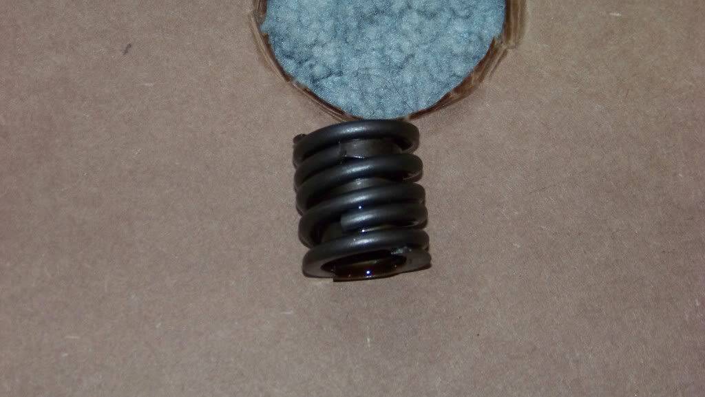

Does anybody else keep a spare valve spring in their glove box? That looks to be #4, since I have 12 more out of a set of 16 left. I think i've changed every exhaust spring on the passenger head now.. but I don't really remember which ones. That's the reason I havent gone ahead and changed the rest. Lunati springs, lunati voodoo cam. To be sorta fair however, lunati changed spring suppliers between the first set and my new set.
For another positive, this is the first spring to break since the Jeg's rockers. This one didnt move out of position or bend the pushrod. So only damage was the spring. |

After 4 tries, it appears that theres enough room for the dampner to hold the valve up. Gotten almost used to it.. start to hear a popping noise, look down at vacuum gauge.. bouncing to beat hell.. yup.. broke another one. |

I sure hope your luck holds on breaking these and not causing any damage.

I have a whole set. They're probably too weak for ya, but here ya go:
Install height is 1.70" @ 65lbs and 187lbs @ 1.24"
1.250" dia
Bind is 1.11"
(hope I'm reading this right) _________________

| These are close to 350# open pressure. And I think i've got .530 lift if i remember right. |

Still think there may be an oiling problem. Oil cools the spring. _________________ A redline a day keeps the carbon away! |
Posted: Wed Jul 21, 2010 7:36 pm Post subject: |
Nothing looks hot, everything is quite oily.. and if you take the valve cover off and start it, look out.
Both sets of rockers oil differently too. This set kind of directs the oil to vital parts. |

Everythings matched set Lunati.
I really think its the first set of valve springs I got. They have changed to a better manufacturer since. I'm also pushing the lift right to the max of what these springs will take. I really shouldnt have used 1.6 rockers. |
