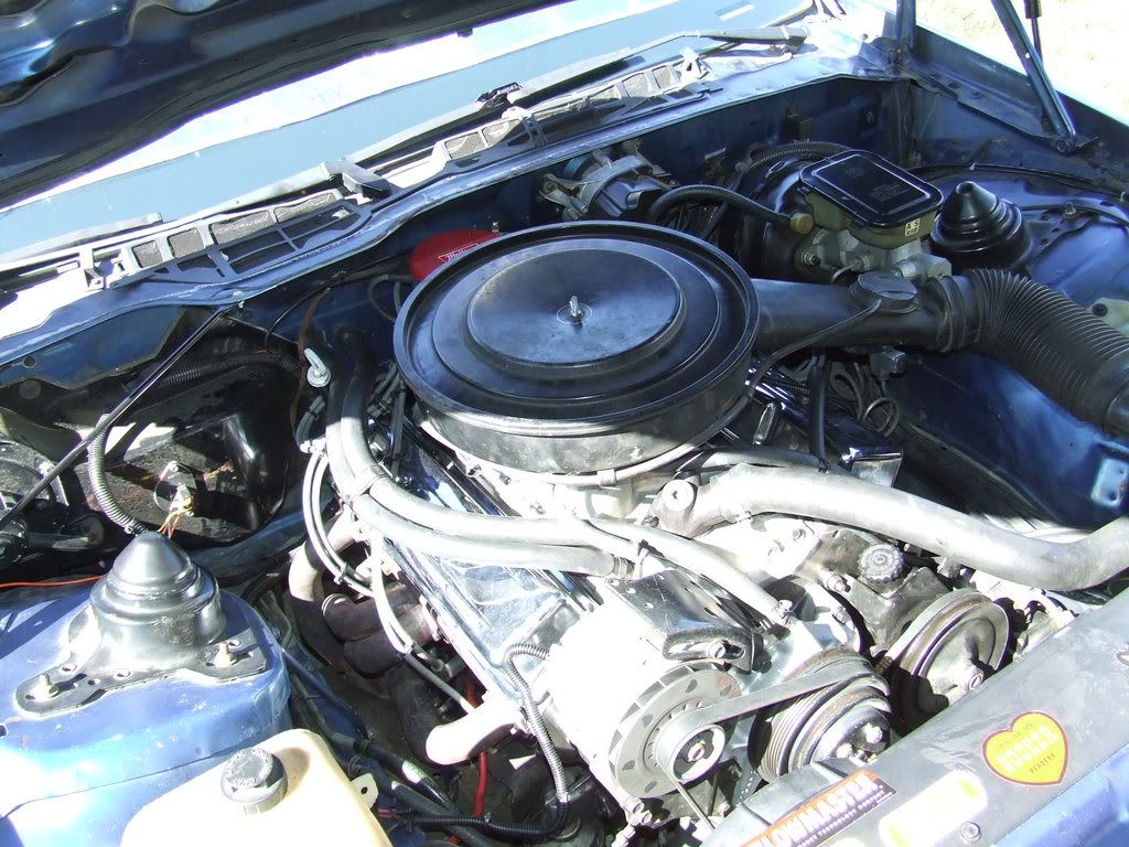

Well I just the car running pretty good, so here is a picture and a short video, at the end of the post.
After I used most of the old gas and got a new battery it is running a lot better.
I just had the stuck oil filter problem today , when changing it for the first time on the new engine. That was a big pita to change the filter when it gets stuck from not putting oil on the rubber seal. I had to destroy the filter to get it off of the block. I will remember never to do that again.
Now just need to keep my foot out of it for a while so it can break in.
The next thing to do is replace that pos megashifter. Anyone got any good ideas? I was thinking of the b&m pro ratchet.
http://www.jegs.com/p/B%26M/745771/10002/-1/10525
I also need to have the rear end looked at. It is starting to make a howling noise that is getting louder and louder. I want to install the 3.70 gear set I have as well, and have the rear end and the posi rebuilt. When rebuilding a rear end is the only precise measurement setting up the posi? Anyone know of a good crew member/shop in vancouver/portland area?
Anyways heres a picture and a video

| The car got new rings. I ran the car for 45-60 minutes around 1000-2000 rpm because of the old gas/battery and the car not wanting to idle correctly. The car will run correctly now, but I haven't really driven it only short test drives while trying to get it running correctly. Should I let it idle at a higher rpm for a while to break in the cam still? |

| I don't understand how the lifters/cam would have insufficient oil, I pumped them up with the oil pump and a drill. I did use the crane cams brake in lube and put in diesel oil after I just changed the oil and filter. The gas in the car was 10 months old, but either way it was running like crap. Live and learn situation I guess. |
