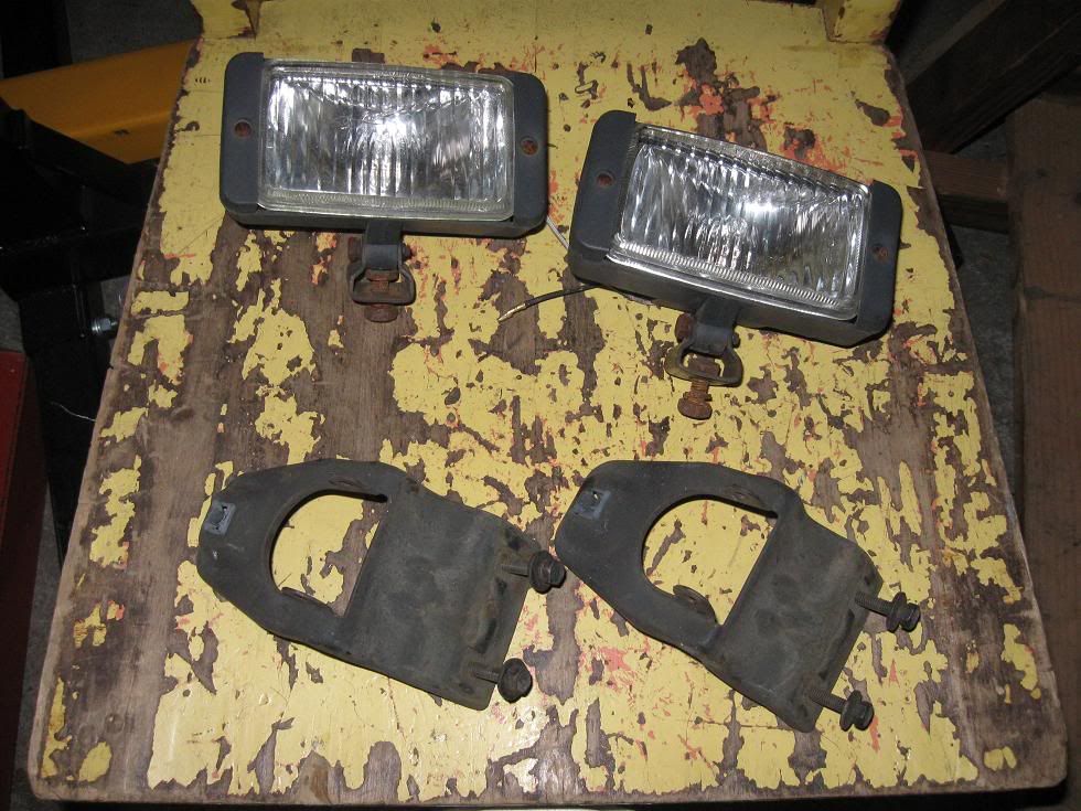

Don't mind the rain and chipped paint. No no no...
I removed the entire plastic piece, and the foglights, then pulled out the air-funneling plastic pieces, the plastic around the radiator where the AC used to be,, and the metal braces behind the lights that really seem to serve no purpose at all. I then bolted the front half of the air dam back up (sans useless metal braces), and used tin snips to cut out what remained of the plastic in the holes.
A quick trip to Lowes netted me some metal screen that you're supposed to use to cover your chimney or something, but it didn't look cheesy like chicken wire. I shot it with primer, and with a little cutting and bending, and a few well-hidden zipties it was done. I filled the holes from the license plate bracket (which didn't come out very well) and then shot the entire piece flat black, except for the 'Camaro' part. Not bad for a couple bucks and an hours work.
If anyone wants the metal brace things, or the foglights (one has a chipped lens), they're yours for a beer:

it does look alot better without the fog lights good job Very Happy

Maybe it's just me, but IROC's need the driving lights. Deleting them makes them look like an RS.

Looks good. Since nobody spoke up, I'll take the lights off of your hands. I have on broken on my Red car, just not sure which one.
