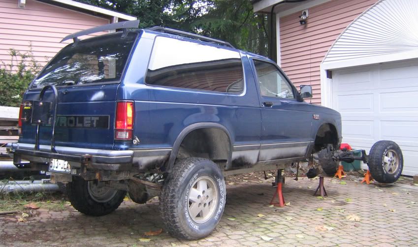

No, this is for my blazer! Very Happy
Ditching the IFS. I got my johnny joints in the mail so I can start on the long arms now.
