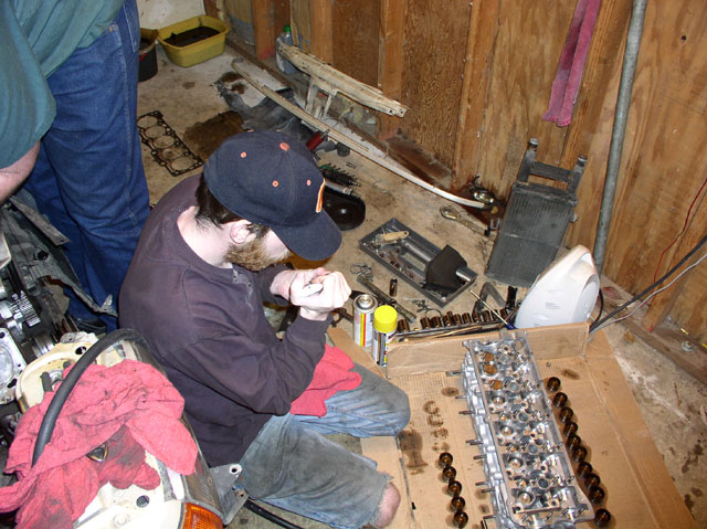

Its been going at a pretty slow pace, waiting for the machine shop, and parts, etc. I finally got started with putting her back together this weekend.

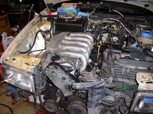

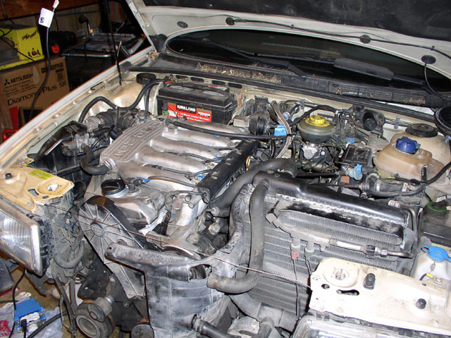

Here is what she looks like (and has looked like for the last month. All torn apart.)

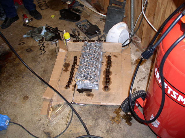

Spent about 40 minutes with the Air tools, polishing the deck surface, so its all ready for the Cyl. Head.
Cyl. Head back from the machine shot. (lookin' good!)

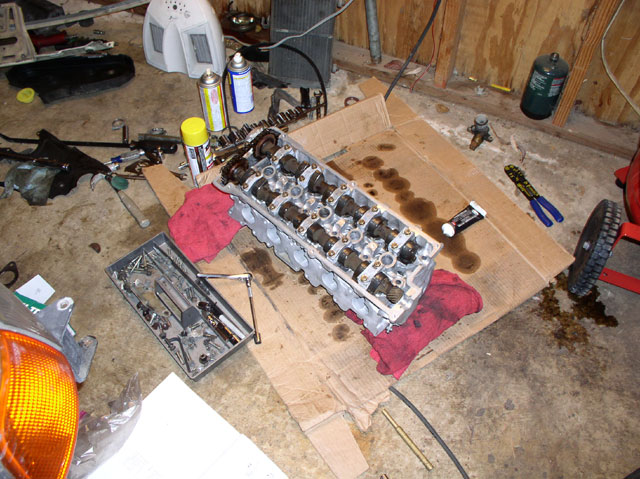

Here I am, lubing up. (ohhh, that sounds dirty)
Once you lube things up good, you can slowly slide it in... (that sounded really dirty).

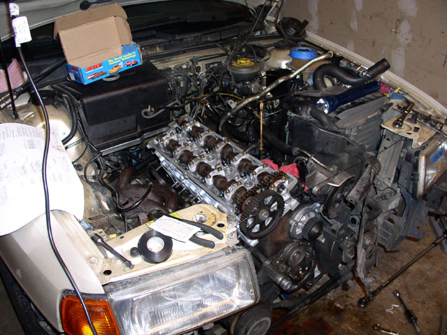

Head all back together, and ready to be put in the car.
So far, progress isn't as quick as I would have hoped. The Germans do things a little diffrently, so we are having to learn as we go.

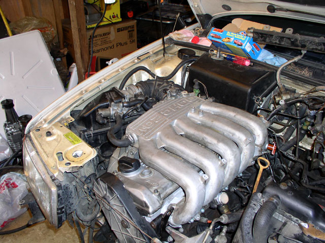

Heh. If I know my audi's correctly. That manifold makes it so that the exhaust has the same distance to travel no matter what cylinder it is from. The stock manifolds are shorter inthe back, and longer in the front before reaching the exhaust. The spaghettit helps even it out and creates more even backpressure.

Posted: Sun Apr 03, 2005 9:09 pm Post subject: |
Pretty good.
You forgot to add, that it is a very rare factory header.

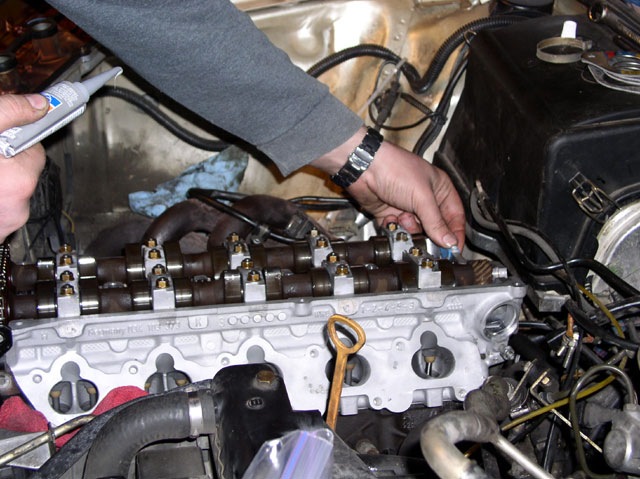

Todays update:
Didn't get much done today. Torqued the head down (got ahold of a 12pnt 1/2" deep socket).

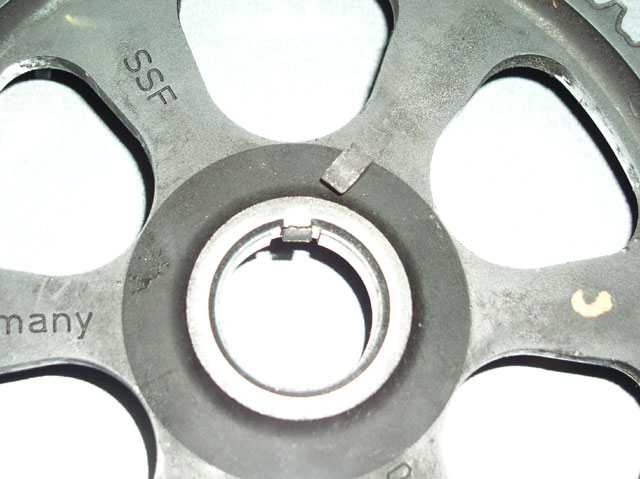

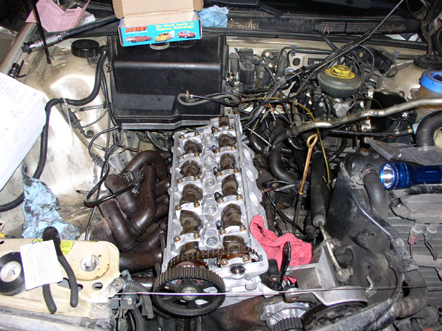

Went to put the timing belt on, and found this:
The keyway on the cam sprocket is broken. I'm actualy lucky I found this now. The I5 is an interferance motor, so the cams going out of time, could have been a disaster.

Update:

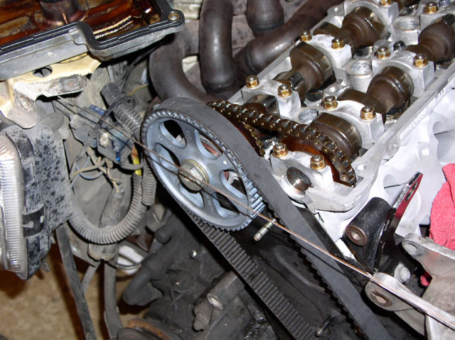

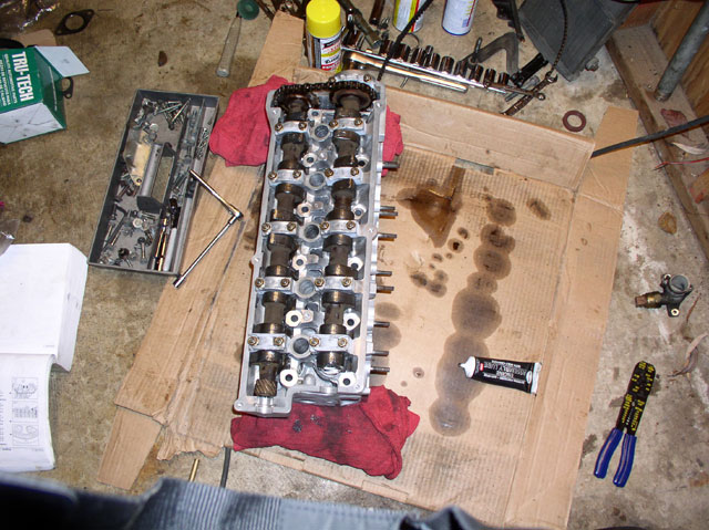

Got the new cam gear today, and started putting it together again...
New Cam Gear, Timing belt also fitted.
Sealing up everything on the head.
Bart: "Gaskets, we don't need to stinkin' gaskets . . . we have RTV"

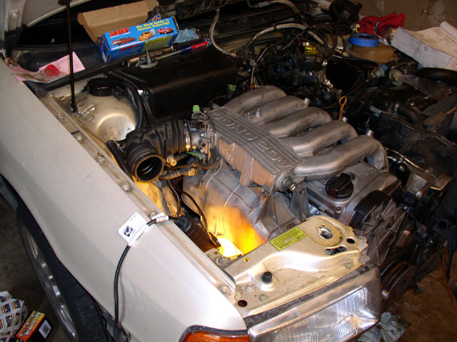

Timing belt cover, exaust and cover, and intake manifold on.
Here is where I left it for the night... Tomorrow, injectors, spark plugs/wires, and throttle body go on, along with the maf and air box. once thats on, I should be able to test fire it!!!!

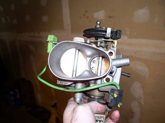

Ok... got quite a bit done today, then hit another wall
The Good:
Cleaned up the TB, all ready to go on.
Started putting the intake back on, this task will make you swear in german.
Got the intake all done, and started on the wiring, and fuel lines, etc.
Basicly, completely assembled Engine!!!!
