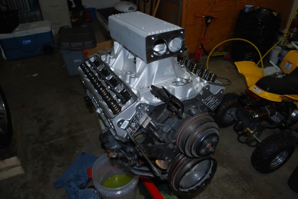

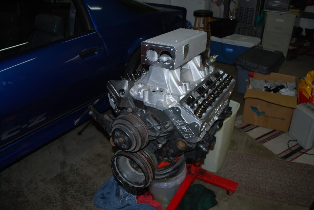

While I am waiting for the cam, I couldnt help test fitting the heads and a couple of intake manifolds.
SLP T-Ram -
http://i299.photobucket.com/albums/mm295/IROCDAVE/1987%20IROC%202009%20new%20settup/SBCroundtwointakes01-01-10005.jpg
http://i299.photobucket.com/albums/mm295/IROCDAVE/1987%20IROC%202009%20new%20settup/SBCroundtwointakes01-01-10008.jpg
Holley Stealth Ram-
http://i299.photobucket.com/albums/mm295/IROCDAVE/1987%20IROC%202009%20new%20settup/SBCroundtwointakes01-01-10001.jpg
http://i299.photobucket.com/albums/mm295/IROCDAVE/1987%20IROC%202009%20new%20settup/SBCroundtwointakes01-01-10004.jpg
I think the T-Ram looks better, wider, lower, and bad ass. Since the swap is at a stand still, which intake do you think looks better? The T-Ram Has been in the car for ten years and will be cleaned before going back in.

I would put money on the HSR outflowing the T-Ram above 5500 RPM. The runners are larger and probably only 1" +/- longer.
The real difference is that the T-Ram has a larger upper plenum and the air has to make three 90 degree turns before entering each cylinders intake runner. Once it is in the runner, it has a shorter distance in a narrower runner to the head. A couple of Buick GNX guys said it would be the perfect manifold for a turbo charger settup becuase of the huge plenum.
