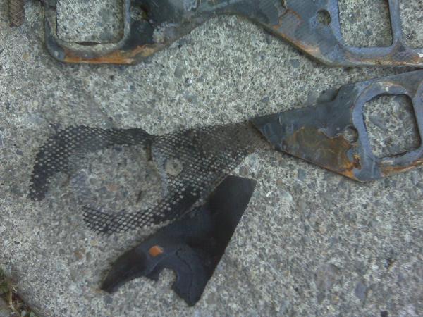

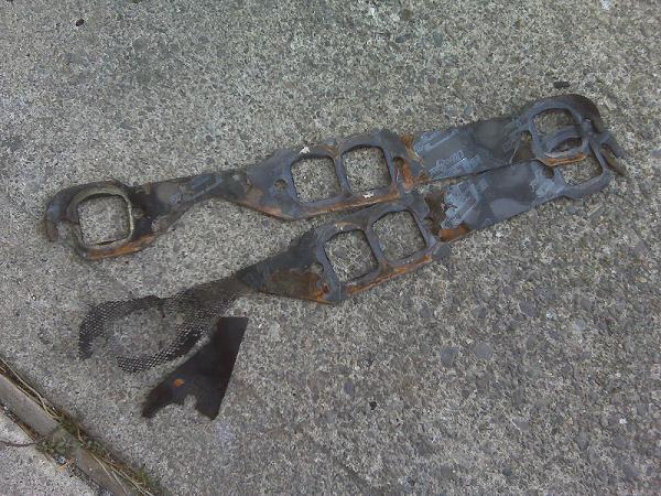

ummm...remeber kids, when you hear that exaust leak, don't just keep keep tightening the header bolts. Wink
PostPosted: Wed Feb 18, 2009 5:10 pm    Post subject: Reply with quote
Dang you got your use out of those Laughing

Your gaskets lasted longer than mine did. Mine looked exactly the same as yours do. I now have percy's dead soft aluminum reusable gaskets and couldn't be happier with them.
PostPosted: Wed Feb 18, 2009 5:41 pm    Post subject: Reply with quote
I couldn't find the Percy gaskets today out here in Gresham, but I did get the Mr Gasket brand reusable aluminum gaskets. We will see how they do. I need to get a few heat cycles through and make sure the header bolts are nice and tight.

I would just use the cheap header gasket. In my experience doesn't make a difference. Once the gasket leaks its junk. Tighten the new gasket when its cold. Then when the engines still hot retighten the header bolts again. Never had a problem with them leaking after this process.

You my friend haven't used a quality gasket with your "process." Using a paper gasket will always end in tragety. I've had the same header gaskets for years, and they've been off twice.
PostPosted: Thu Feb 19, 2009 12:31 am    Post subject: Reply with quote
I hate Mr. Gasket products so much. I have never seen anything they make that wasn't crap, nor have I had any of their gaskets of any type last more than a few thousand miles.
I will say +3 on the Remflex's though. I put one on the passenger side of the IROC (warped header flange on that side, was blowing out double-stacked Mr. Gasket's every 500 miles) and it's lasted about 2K now with no retorque, per their instructions.*crosses fingers*

I don't know.... Looks to me that there was still some life left on cylinders 4 and 8.
