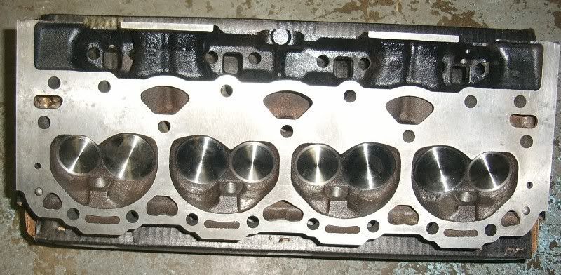

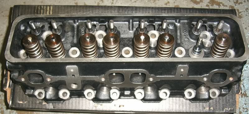

Here are pics of the vortec heads I got from scoggins/dickey. Price was good, $680 shipped. (free shipping special) And they were out of the standard upgraded heads, so I got the more upgraded ones with stainless valves and supposedly good retiners and locks for the same price Very Happy Although I can't see why these retainers are so great. Anyway, nice stainless valves, vavle giudes cut for PC seals, screw in studs.
The bad..........they are dirty..........gritty. No way would I ever put these on a motor as they came out of the box. I wish I could take them to work and put them in the large vacum degreaser we use for 747 flap tracks. That would do the trick.
About the only mod I'll do to these heads is blend the oil drain back holes in the end of the heads some, and clearance the pushrod holes a little in case I ever want to try 1.6 rockers.
Next part on my shopping list are a set of Keith Black -12cc D-dish pistons and rings. They will give me about 9.3/9.6/1 compression ratio depending on head gasket thickness and if I decide to zero deck the block. I want to get the quench side close, but no too close for the street. Just don't want it too sensitive to octane numbers.
PostPosted: Wed Dec 05, 2007 6:01 pm    Post subject: Reply with quote
A nice tight quench will actually improve your resistance to pinging. Shoot for 0.040. Some people try to push it even tighter but 40 oughta do it.
PostPosted: Wed Dec 05, 2007 6:48 pm    Post subject: Reply with quote
That's what I was getting at about octane numbers The closer the quench the better up to a point.
If I zero deck the block, all I'll have is the gasket thickness as quench distance. From what I read, usually the pistons on an average set about .025 down in the bores, so with a .038 gasket I'll have a .063 quench clearance without cutting the block. I'll get the block bored and honed and do a trial assembly and see how everything works out before doing any decking.
