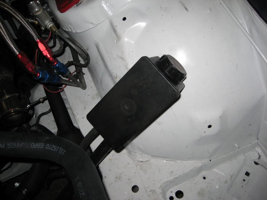

Can you use the factory fourthgen veesix unit?
Works fine on my car. I just need to cut the bracket down and hard mount it.
PostPosted: Sat Jan 12, 2013 9:56 pm    Post subject: Reply with quote
Have a picture handy? I was just going to go through the junkyard until I found one that I could use. I realized this morning that I could've used the BMW unit but I already tossed it. Laughing
PostPosted: Sat Jan 12, 2013 10:12 pm    Post subject: Reply with quote
Embarrassingly no, as I only take pictures of dumb, useless stuff, so I had to venture out to my own cold-ass garage to take one. Laughing
The low pressure line is 5/8". I think the high is 1/2". Baffled internally. Bought new lines from WOFSCO. Bracket not shown as I forget where it is (but it's around, I assure you). Embarassed
The 90's B-bodies used a similar reservoir but it was shaped differently (to fit around a fenderwell) and I am not sure what type of bracket it used.
PostPosted: Sun Jan 13, 2013 12:13 am    Post subject: Reply with quote
Yikes. That has some height I don't think I can deal with. How tall is it overall?
PostPosted: Sun Jan 13, 2013 9:21 am    Post subject: Reply with quote
From the top of the cap to the ends of the hose barbs on the bottom is ~8". The reservoir body itself is under 7".
If you're worried about size look for a B-body can. It's shorter, fatter, and the hose barbs are angled. Here's a random Google pic:
