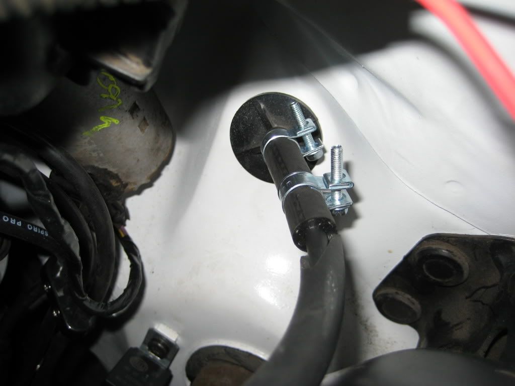

If you've gotten to the annoying "fourthgen cable through thirdgen firewall" part of the build I just cut the thirdgen firewall clip off, ran the fourthgen cable through it, then used a piece of fuel line and clamps to brace it.  |

Jon, you have put way to much thought into this. Think less like an engineer and more like a caveman. If you need to squish a thing you merely bang it between two rocks!
Just set the swage on the anvil (or on a sturdy steel bench, or even a concrete floor) and hit it with a hammer. It's just aluminum after all.
| Twilightoptics wrote: | | Whats the difference on the TB? |

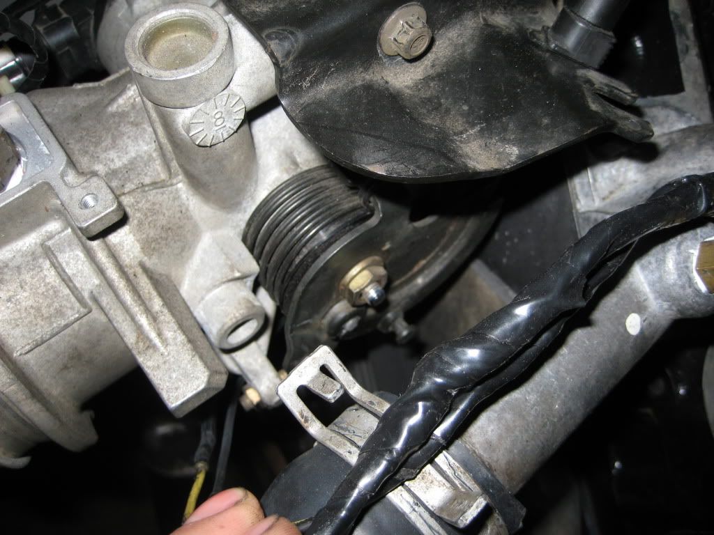

Both the clip on the TB bracket and the pin on the end of the cable are totally different. Also the length is wrong.
*Edit: Went out and took some detailed pictures. This was one of the expedient projects I did when Gabe and I were over here making this thing drivable as quick as possible, but it seems to work so I'm down with it. Note my use of good EFI line and clamps for added strength.

Look closely at the ferrule in my last picture. The aluminum has compressed the steel cable completely flat. There's no hit-or-miss to be had. I have had swages pull when using a swaging tool, I have never had one pull that had been beaten down.
FWIW I think you are too focused on joining the outer layer of sheathing. Pretty much all that does is keep the inner spiraled steel sheath dry. You need to use a tube of some kind to hold the inner steel sheaths together so that they cannot move in shear. |

I see you basically used a coupling to join the two pieces. I might end up doing that if I can't work out my ideas. Thanks for the good info!  |
Posted: Thu Oct 25, 2012 8:10 pm Post subject: |
I remember trying to slip the fourthgen cable inside the plastic connector as you are talking about, but I ended up just making a butt-joint. I forget if I did that because it wasn't possible, or if it was just taking too long.  |

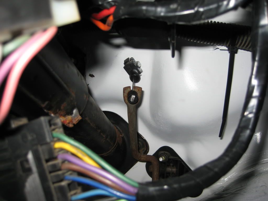

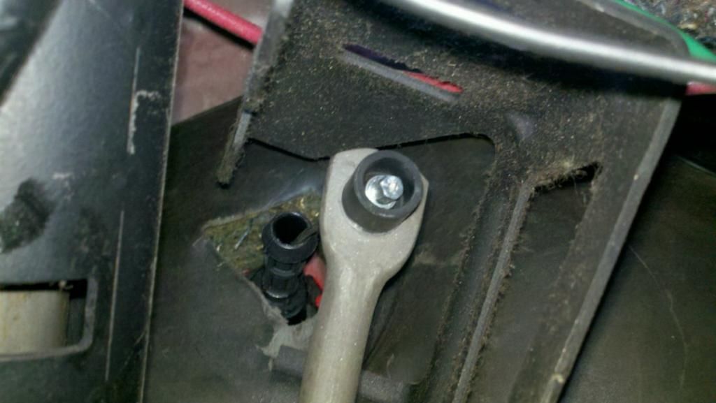

I just went out and checked. Yeah, washer epoxied to the firewall. But no knot? I'll grab a picture.
Edit; looks like misalignment of the cable. However, I've put over 40k on this cable and haven't had any issues?
Posted: Fri Oct 26, 2012 10:07 pm Post subject: |
It's designed with a bell-shaped opening.  |
