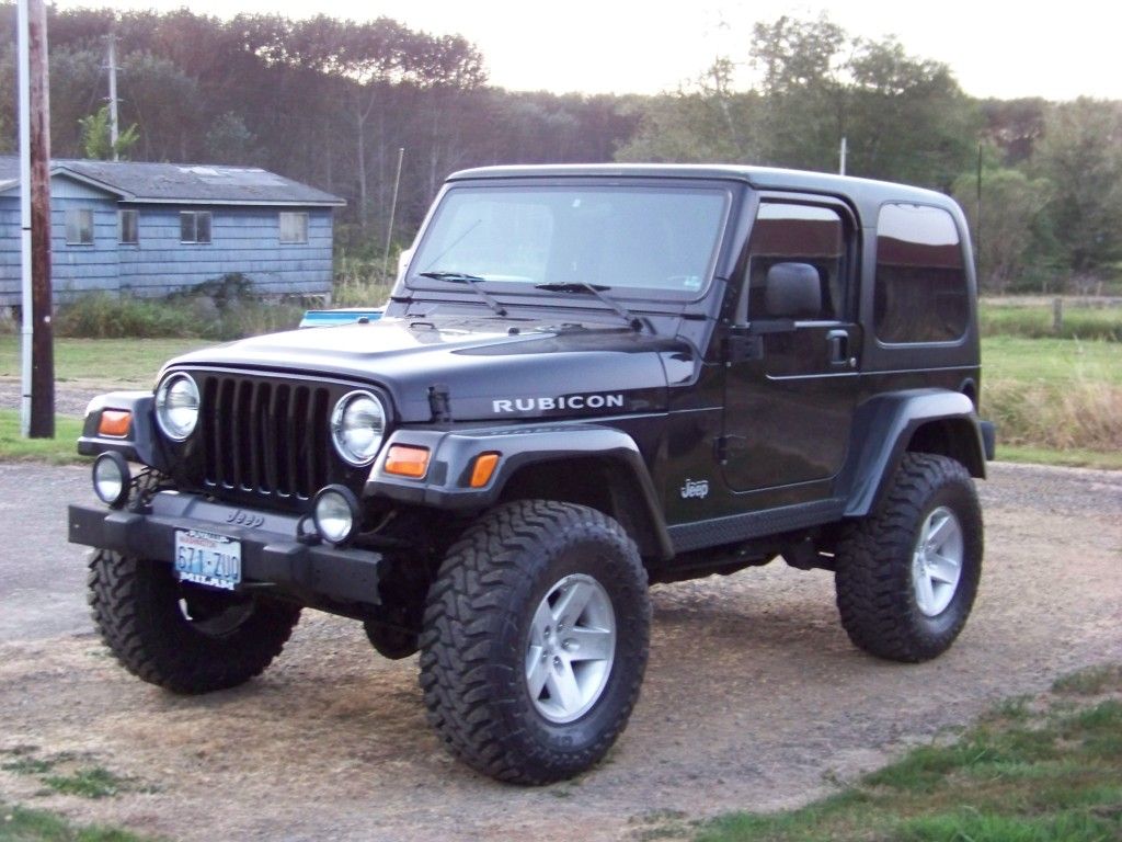

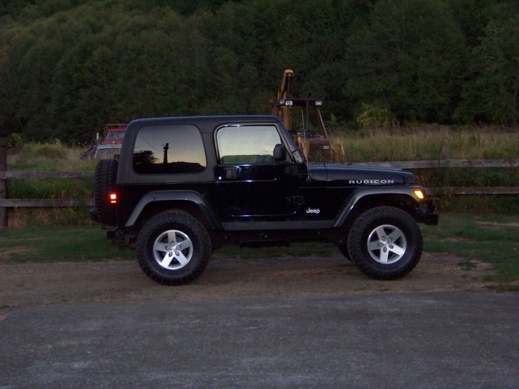

Sorry.. havent done a whole lot with the 3d gen.. been modifying the jeep of course! Anyway.. I bought 33's.. 305/70r16 toyo mts. Which are 12.2x33. By the price I thought I was buying a car or something, but damn.. they look good. Needed a little more space since I only had a 2" lift. So I bought a 1.25" body lift and a motor mount lift so that I wouldnt have to modify the fan shroud or shifters. Finished up tonight and here's how she looks. Very Happy
There's 6" of space to the fender lip up front and 5.5" in the back. Maybe a winch will even that out? Laughing It's a sickness... Inside edge of the back tire is fairly close to the tub yet though. Probably eventually put some wheel spacers on it.. though I like where the tire sits now compared to the fender. Anyway... show off at heart so I had to post it up.

Looks really nice! Cool
PostPosted: Wed Oct 03, 2012 8:41 pm    Post subject: Reply with quote
Time to ditch those POS aluminum foil bumpers.
PostPosted: Wed Oct 03, 2012 8:43 pm    Post subject: Reply with quote
New tires are good, and the "driving uphill like an old lead-sled Merc" look seals the deal! Laughing
Now you just need to bang it up on the trail.
PostPosted: Wed Oct 03, 2012 8:51 pm    Post subject: Reply with quote
Ya.. problem with a jeep is.. what to do first! I've been looking at bumpers but they're all big $$ Would also like a set of Poison Spyder Ricochet Rockers too..
I actually kinda like the "merc" look LOL I imagine the rear springs have a bit of sag in them. Someday maybe I'll actually put some lift springs in instead of these spacers.
And thanks Jon.. I really like this rig. Very Happy
PostPosted: Wed Oct 03, 2012 9:02 pm    Post subject: Reply with quote
First thing truely is to change out/build a new skid plate inplace of the "shovel."
Put the soft top on and the rear levels out.
PostPosted: Wed Oct 03, 2012 9:07 pm    Post subject: Reply with quote
Use giant piece of square steel tube for front bumper: bumper problem solved, money problem solved, suspension angle problem solved. Cool
