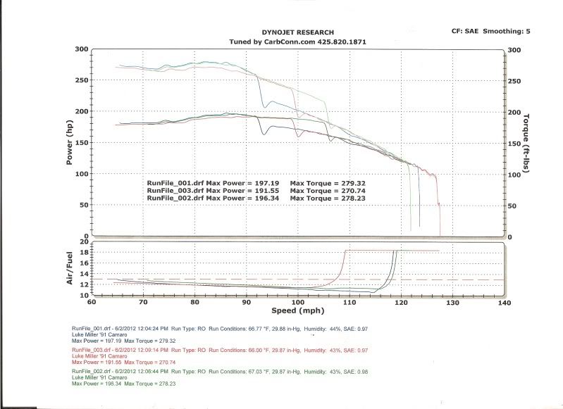

so expecting to have at least the same or better numbers than last year, the dissapointment continues..
last year i was at 200hp and 300tq
after my first pull engine light came on, i had been having troubles with a chip i have so i swapped it out on the dyno, this chip has been good so far no engine light its the stock AUJP. i think the only thing i did was turn off EGR. i may have put a tune on there i made previously, where i just adjusted AFR vs RPM by what my WB02 says as im driving.
anywho, what do you guys think is causing this?
is it something in the tune? if its a tune i made then it should get richer not leaner cause i only made adjustments to 4000rpms, didnt know my car would make it to 5k on the dyno
besides fixing the tune, what else can i do to the car, would a LT1 cam help at all?
i know TPI is garbage beyond 4000rpm but i love the look of it, i just wanna get the most out of it i can, aluminum heads are in the future

That some nice torque though.
PostPosted: Mon Jun 04, 2012 7:38 pm    Post subject: Reply with quote
Graphs make more sense, at least to me anyway, when you graph vs rpm instead of mph.
Yup yup
You can more easily spot issues that arise at a certain RPM.
Some other thoughts:
No sense spinning a TPI past 4500.
What code was the old chip throwing? If it wasn't a code for bad prom then the issue may well still exist.
Is this still a MAP TPI on a 350 with a carb Summit cam in it?

code was 51 bad prom
its a speed density TPI on a factory roller cam
ill email carb conn and get my other graph with RPMs instead of mph
PostPosted: Mon Jun 04, 2012 8:05 pm    Post subject: Reply with quote
If you have the DRF file you can do it yourself in WinPEP.
PostPosted: Mon Jun 04, 2012 8:38 pm    Post subject: Reply with quote
Change that to RPM.
Looks like a rich condition, especially if you were in limp home.
PostPosted: Tue Jun 05, 2012 12:33 pm    Post subject: Reply with quote

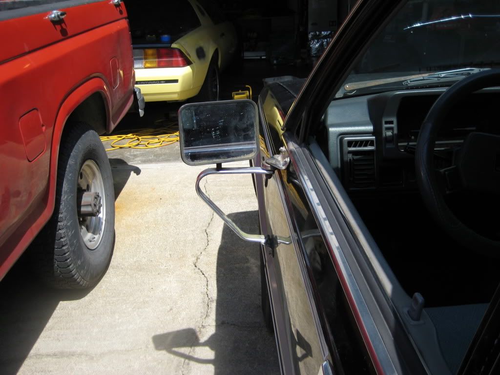

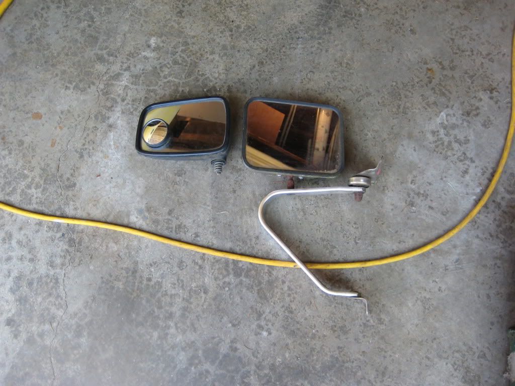

The mirrors on the "Banana"?
If you were going for weight reduction, why not just keep a Drivers side only?
PostPosted: Sat Jun 09, 2012 12:57 pm    Post subject: Reply with quote
Haha!
Chris, you know me, buddy, I can't leave well enough alone. There's an entire Crew topic about those mirrors:
http://cascadecrew.org/phpBB2/viewtopic.php?t=8800
They weigh about half what a power mirror does so it sort of is like having only one! Laughing
I have driven vehicles with only one mirror, and a vehicle with no external mirrors (stock) and I am not about it. Hell, I even took the silly car-style mirrors off the Mazda and swapped on baby towing mirrors:
http://i151.photobucket.com/albums/s131/aaron_sK/mazda/mazda006.jpg
http://i151.photobucket.com/albums/s131/aaron_sK/mazda/mazda007.jpg
