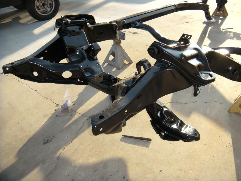

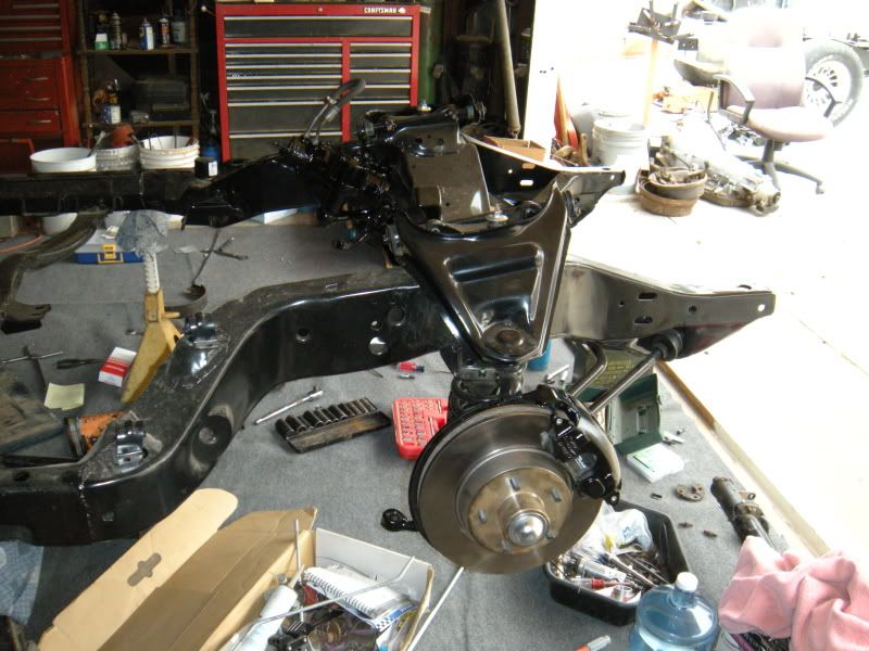

The full size cars impala's and such all had their steering behind the crossmember. not in front like the chevelle/malibu/nova.
Here's a pic of a 68.. notice the arm for the tie rod end behind the rotor. Also the front end uses radius arms forward of the lower control arm. By this time the chevelle was allready using the suspension we are used to.
And a pic of the lower control arm itself.
I just happen to have owned a 68 impala and chevelle. Wink
