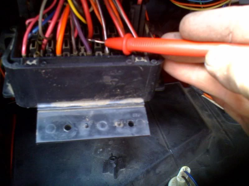

After a lot of checking I've found that I have no power to the accessory buss on the fuse block. The one I'm pointing to in the pic is the wire that has no power to it. I took a jumper wire and put power to it and everything works. I checked all the fuseable links by the starter and they are all good. Other than a broken wire I can't see why there is no power.
Ideas?
PostPosted: Sun Jun 12, 2011 6:08 pm    Post subject: Reply with quote
The purple wire or the red one? Is there power to it at the fuse block? If not, then the problem is most likely in the block, possibly a broken bus bar where the wire attaches. If yes, then you most likely have a broken wire.
PostPosted: Sun Jun 12, 2011 6:43 pm    Post subject: Reply with quote
The red wire. Everything else is fine. I jump power to the red wire from an external source and everything works perfectly.
I would hate to run an external wire to power that part of the box, but finding a break in the harness will be extremely difficult I think.
PostPosted: Sun Jun 12, 2011 10:27 pm    Post subject: Reply with quote
Looking at my factory service manual. I see several fusible links on the starter. One of them powers the hatch fuse, light switch, courtesy fuse, and it's difficult to follow, but at least one or two others.
Just because a fusible link appears to be fine, does not mean they work. Use a test light (or DVOM) and check for battery hot on all those wires, check them again after the fusible links. That should be where your issue is.
If the fusible link is ok, and you have power flow from there, the accessory power wire joins the large loom that is bolted to the transmission bell housing. You are not getting those wires loose without pulling the transmission, or getting lucky. Unless of course you were smart enough to pull those clips the last time you were back there Wink
