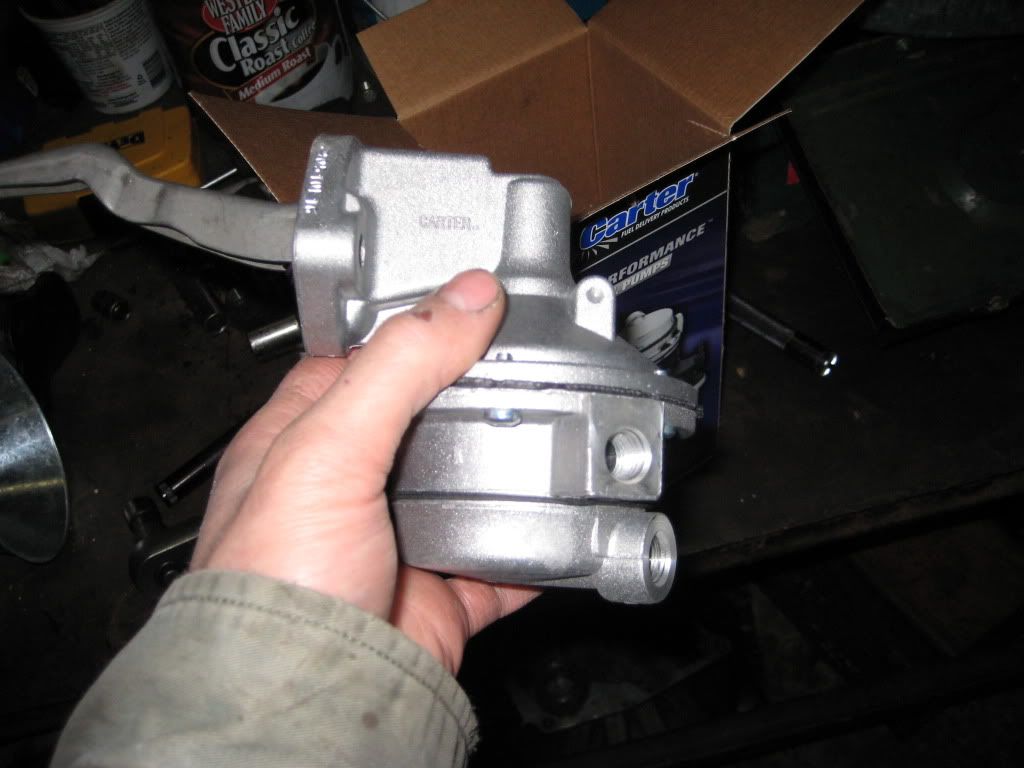

No fuel pressure getting built there.
I don't know if it was a defect in the rubber or what, but I doubt that Holley intended it as a 15K mile replacement part. If it was an SBC pump I could just buy a rebuild kit for it, but noooo... Rolling Eyes
...so we just bought a Carter. Razz

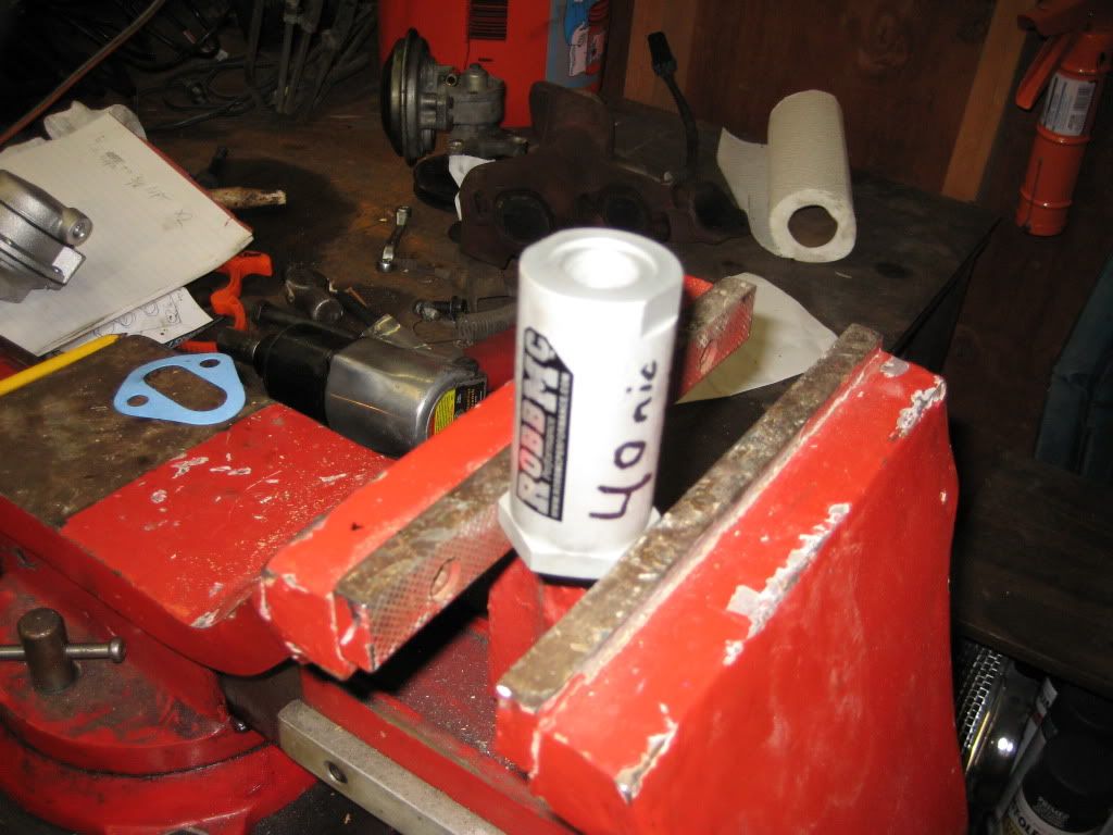

Also, in the interest of the insides of the tank and line not ending up everywhere, it's pre-filter time:

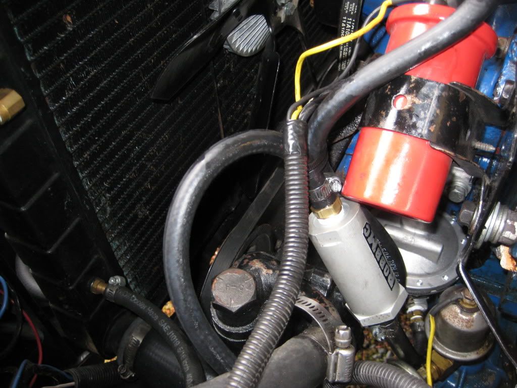

And installed...
And the regulator with post-filter:
Yes, there's more than 12 total inches of rubber fuel line in the system. Wink
