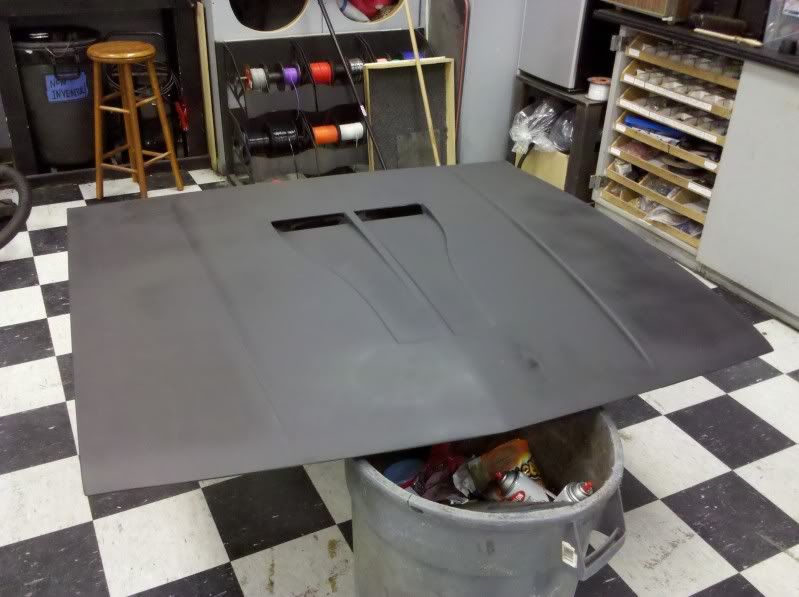

So after i got it back to the shop i started by taking the entire hood off again (which by the way is a lot more awkward to undo and hold the thing yourself)
i figured i should start by getting that snapped bolt out, so our snap on rep came by and i bought a screw extractor set, and then when i was drilling into it i snapped the damn bit off in the bolt.... so then i went to home depot to find a colbalt bit, spent waaaay too much time on it so i said screw it and just ran the 1/4" bit through, ran a tap into it and threw a bolt in there so theres one problem fixed
Then i sanded down the entire thing and found a couple more cracks, mainly around the vents and 2 scratched up spots on the front, so i mixed up some duraglass and started getting to work on patching the chips, used some resin on the corner to harden the loose fibers, and then built out with it to reconstruct it, sanded it all down and the got down to priming it up, not a perfect job but looks really arent my thing lately lol anyway, heres a couple pics theyre pretty self explanatory

I like those hoods. Looks good! Do you work at a car audio shop?

that looks good man, good job!

Its cool bro. Whenever we see each other again is cool. Nice job on the hood BTW! Cool
PostPosted: Wed Feb 02, 2011 8:50 pm    Post subject: Reply with quote
Nice job on the hood...you should primer your whole car like that.
