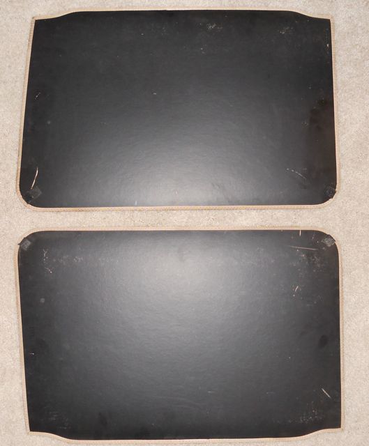

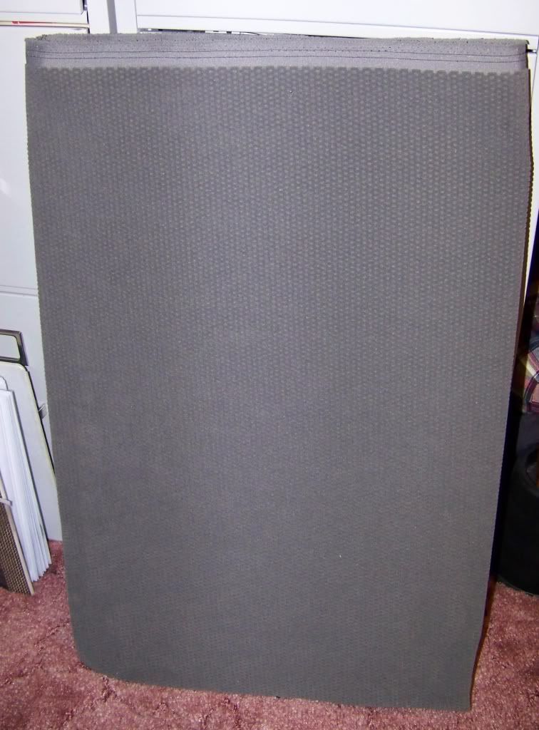

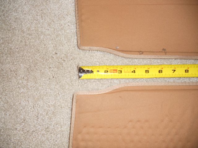

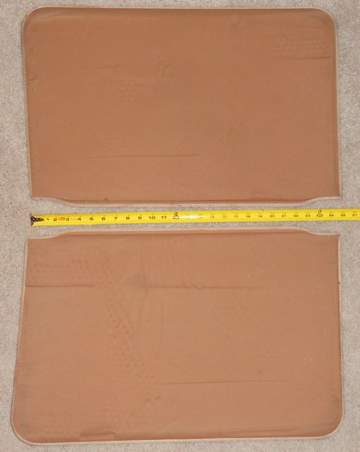

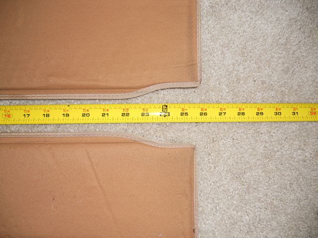

Ok here are the pics. I have the material to recover mine but haven't done it yet. They have been smushed into a closet.
They are flipped over so keep that in mind. The cloth side actually goes down and matches the headliner material. In the first pic, the passenger side is on the top and driver side is on the bottom. The edge to the left is front of the car. Rounded edges follow the contour of the t-top opening and straight edge is out toward door.
Dimensions
L 26 7/8" (inside edge toward T bar)
L 25 7/8" (outside edge that goes toward window/latch)
W 17 1/4" (before indentations)
W 16 1/2" (at indentations)
Hopefully that makes sense looking at the pics. There is a taper in length from inside (T bar) to outside (window) at the front of the car. The back edge is straight across (other than rounded corners of course). The 2nd and 3rd pics show the 'indentations'. Rich mentioned some differences side to side but mine are clones of each other.
The material is a hard cardboard type backing, a thin foam pad approx 1/2" thick and then covered with headliner material. The edges have piping sewn around to hold it all together.
If that doesn't make sense just ask... been a long day lol.
Here is a pic from the top of how they would sit in the car
Cheers,

Posted: Tue Oct 12, 2010 8:01 pm Post subject: |
Nice job Mr.Bones!
Whiskey Chick, note the cut outs and the rounded edges...crucial!
No they don't slide in, I tried...forget about it!
The way the shades fit, take the T-Tops off, lay the shade on, the velcro holds it in place and the thin edge of the shade will fit on the plastic lip of the top by the latch.
I will post a pic shortly of the homemade gig!!
I hope this is helpful, but the pics Schultzy put up are great!
Tricky little dudes they are!  _________________

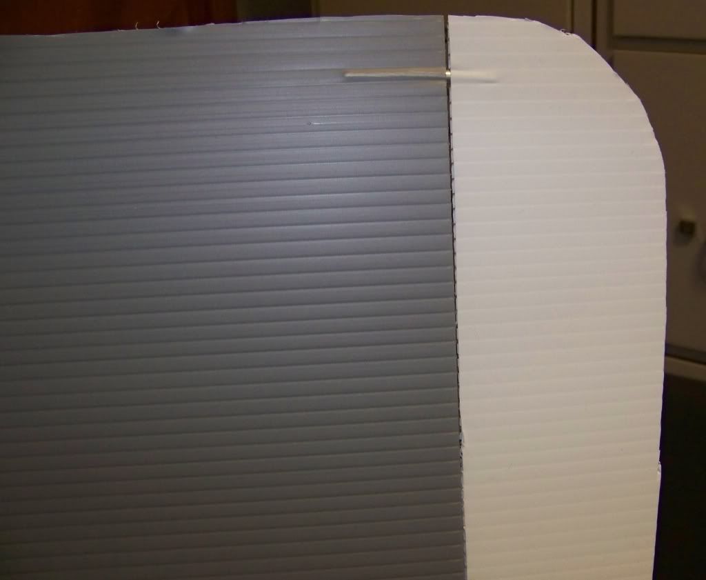

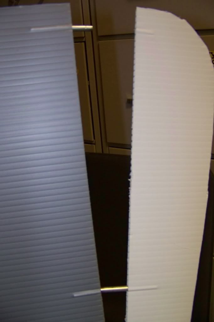

Posted: Tue Oct 12, 2010 10:26 pm Post subject: |
I used Polycore it has the durability needed.
The sheets are shorter then required so I used some 1/8" round stock to add a piece to make the length correct.
I had left over cloth from my seat upholstery and took that and sewed it so the polycore could slide in, I am going to put my Shark logo on the down side of the material.
