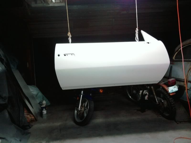

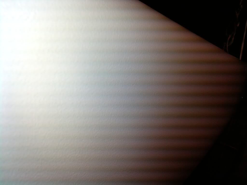

I painted my door with epoxy primer but it is not flat, I think I just have to mess around with my settings.
it sprayed on bumpy, but where it is kind of thick, it is smooth, I think I just got scared and put the "wet" coats on too light, but I'll figure it out soon!
any suggestions welcome!

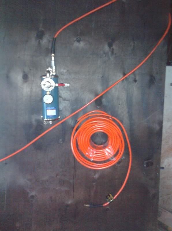

also, does length of hose effect anything? I wouldn't think so but I am using 200 feet.

water filter/hoses

can see bumpty in this picture (camera phone!)

Do you have a regulator and gauge at your gun? If so the hose length doesnt matter. But if you dont spraying metallic will be a trick. The air pressure will spike and drop every time you pull or release the trigger.
PS.. use a disposable moisture trap/filter at the gun too.

I think I corrected my peel problem by decreasing my hose length and increasing the pressure. And if I'm not mistaken, the further away you have the water separator the better. And you can always wet sand the orange peel.

Know im kinda late to this, but yes the hose is important.
You need a shorter hose with a larger diameter for best results.
HVLP guns are air Hogs.
Best bet to try to cut down on air consumption is to not run a full fan on the gun your using. Turn the fan pattern all the way down, then open it back about a 1/2 turn. I use this trick for spraying primers on the floor, that way I get minimal peel but dont have as much overspray and can use less air pressure, and therefore use less air in the process.
It does look like you put your epoxy on too light from your pic though. Try putting it on a little wetter, and if your worried about runs try using a 75% overlap instead of 50%. Worse comes to worse, let it dry, block out the run and throw one more coat on it Smile
Do a little test spray on some paper, keep the gun 8" away, and pull the trigger for one quick spray. Check the outside edges of the pattern. If there are even sized drops uniformly throughout your good, if the outer edges have larger "lumpy" spots, you need more pressure.
