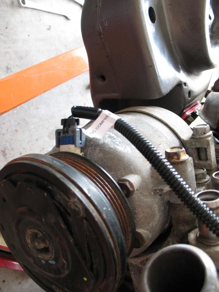

The camaro pan has to be used. The vette doesn't fit, the truck hangs WAY too low, the GTO sump is in the front and would be right where the kmember is.
From what I've seen you can use the vette accessories although that will mean if you want to retain AC you'll have to use the vette stuff mounted low on the passenger side. You have to notch the kmember for the 4thgen so you'll need an even bigger notch for the vette stuff. (The vette acc sit closer to the motor than 4thgen.
All that would be using the 4thgen/vette compressor. However, you can get brackets to mount your thirdgen compressor high up on the passenger side.
