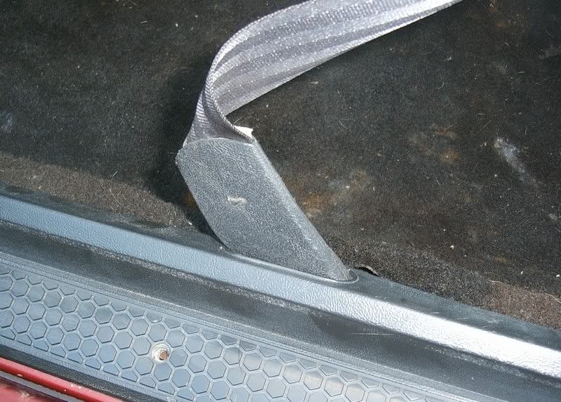

Since I had the interior done, and have taken a few pics, I realized that I have to change out the seat belts!
The stock ones are beat, Embarassed and I am looking to go to black, front and back.
If anyone has a lead on a source please hook me up!! Idea
I am looking for new, or if used in the condition of Holy Immaculacy!
Black is the color, it will really look good with the interior, the backs are perfect
But wont match, but I am in a serious quest for the fronts.

You might want to consider 4th gen front belts. Pretty easy upgrade and only one retractor to deal with.
They are plentiful in the yards.

The belts in my car are out of a 01 maro. So 9 years old verses 23 years old. I could never find a good left 3rd gen belt in black that wasn't trashed or worked properly. On the 82 3rd gens there was only one retractor and then in 83 they switched to the dual retractor setup. Then the 4th gens went back to a single retractor. With two retractors there is double the chance for failure. In a crash you have to rely on two retractors working, nut just one. So in my mind I feel safer relying on one 9 year old single retractor, rather than two 23 year old retractors. And my setup looks totally stock. If you didn't know the difference you could never tell it wasn't and OEM setup.
Anyway just my opinion, take it or leave it.

You can also modify the 3rd gen sill plates by using another sill plate of the same color to cover the hole left by the old retractor. A guy on TGO did it and they looked great. The 82 sills are very hard to find anymore. I got lucky and found two sets.

I dont think it would be to difficult to get the 82 sill plate if you were will to die them black or grey.
