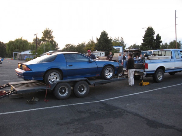

Got loaded up... headed down the road... and saw a cloud of smoke coming from one of my trailer tires.
It was my fault. I put new axles on it, and when me and a buddy welded (well, he welded) the.... I guess you'd call them "cradles" or something like that onto the axles that would then sit on the leaf spring to keep the axle from torque twisting when the brakes are applied... I (we) forgot to center the axles evenly side to side.
So, both tires on the passenger side were rubbing under load; not bad enough to notice when in the air, but certainly bad enough under load to be a major problem.
I took 4 hours to try and move the axle over, but because those cradles were welded on, the axles couldn't move over due to the close tolerances and the U Bolts.
Eventually, I got it back in good enough shape to drive the car off, and then drive it home (about 2 miles... REALLY felt different with the drag tires on it) grab my little pick up and some crow bars and head on back to my rig.
With Danielle holding the flashlight, I was barely able to move the worst axle enough to get about an 1/8th of an inch tire clearance and haul it home.
I've still got the old trailer that works perfectly well, and I've now got to pull the new axles off the new trailer, cut the cradles off, smooth the axles out again, put new cradles on and re-weld them, this time in the right position.

PostPosted: Sun Sep 27, 2009 8:38 pm    Post subject: Reply with quote
Flip the trailer over upside down so you can place the axles perfectly where they belong.

Well.... it's a big trailer. REALLY big.
When I brought it home:
I've added some stuff... like lights and so forth, but here's an older picture without the lights
And here it is last night, loaded up.
Flipping it over? I dunno... looks a little too hard to do that to me.

I dunno what you have to work with, I have always used a forklift.
The axle placement looks wierd too, way to far forward. I see that it is a tilt deck, but still looks like the car needs to be forward a ways. My dad and I built my car trailer and the back tires on my Camaro sit almost on top of the back axle on the trailer. Yours looks like it could get a little wiggle happy at freeway speeds. Mine is absolutely solid up to 80 mph.
PostPosted: Sun Sep 27, 2009 10:22 pm    Post subject: Reply with quote
I had this GTA on backwards, but you see where I pack a car in relation to the trailer axles.
PostPosted: Sun Sep 27, 2009 10:27 pm    Post subject: Reply with quote
Another one with my carmaro on facing the right way.
PostPosted: Mon Sep 28, 2009 7:35 am    Post subject: Reply with quote
Ive always parked the car on the trailer centered over the axles whenever possible.

Even if I don't get the tilt fixed, I've still got the ghetto trailer. In fact, I pulled a friends busted fox body out of PIR with it yesterday afternoon.
So, especially because Saturday shows as rain, Friday might be the day.
I found out the hard way how balanced the trailer is for purposes of reduced tongue weight... I popped it off the hitch without putting something down to block the tires, and it took off across my yard into a tree.
Typically, I just stop the car a foot or so after the deck tilts down. Before I had the axles welded, I towed a Bronco over to Seaside without any trouble.
I don't have a forklift handy, so I may have to find some other way... but the ingenuity of the American GI continues to astound the world.
