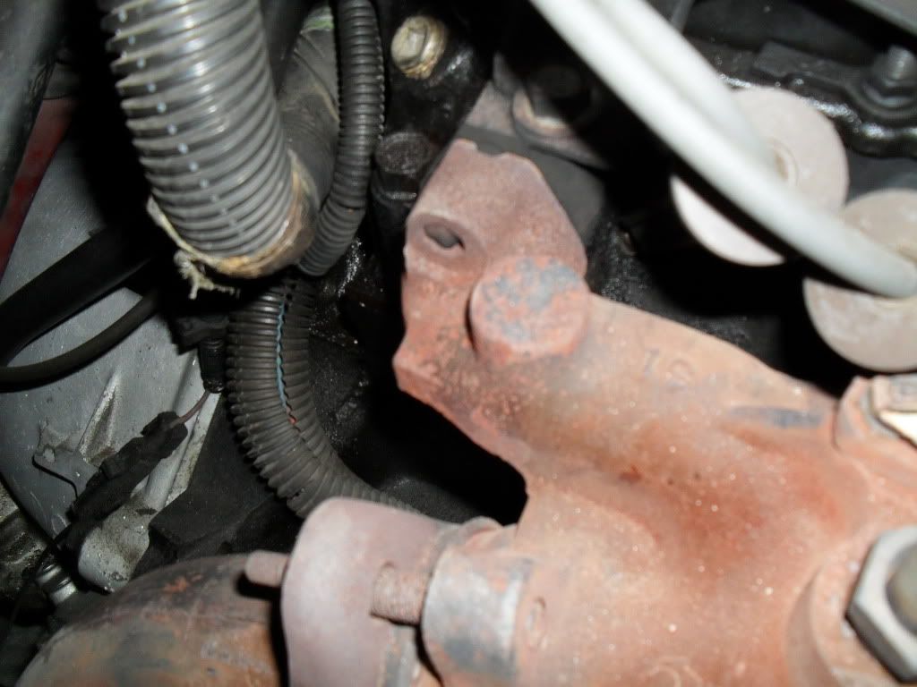

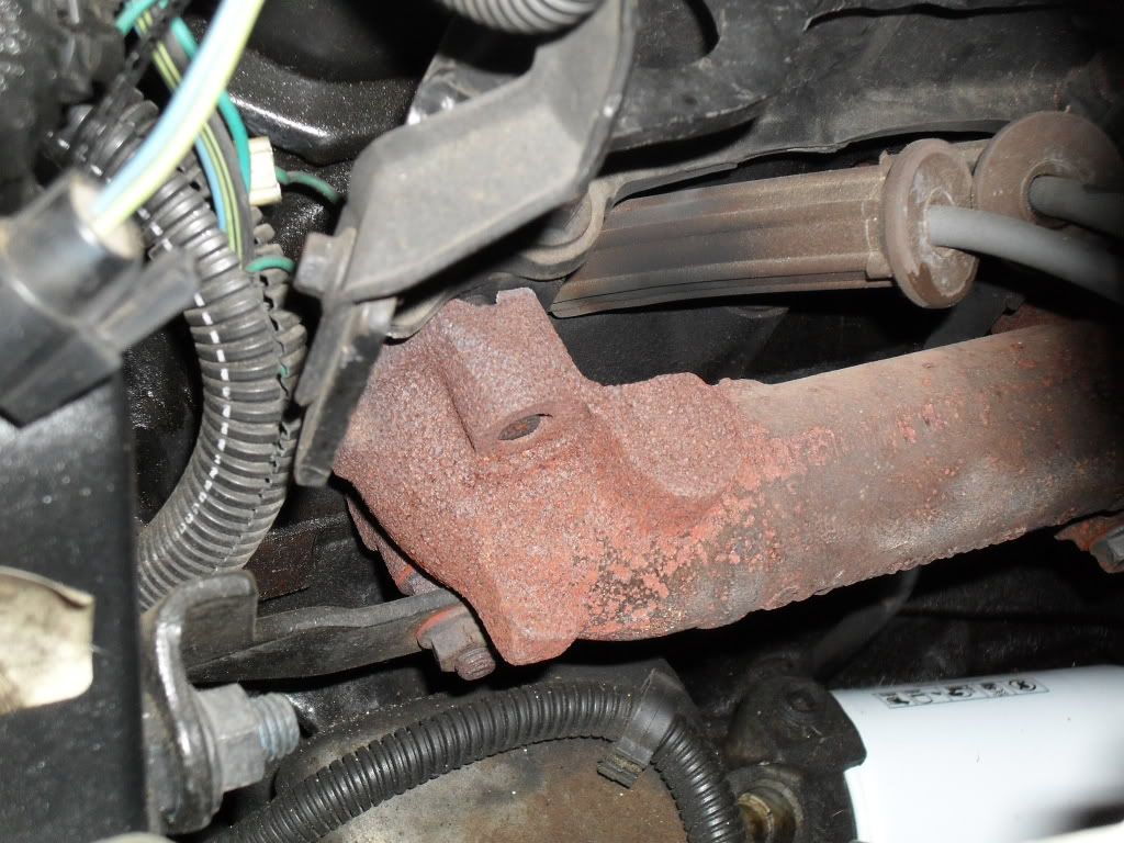

PostPosted: Thu Jul 30, 2009 5:14 pm    Post subject: Reply with quote
well now that i remember that day the cat hit the ground on a steep hill, then i found these...(no wonder walts wanted $300 to fix my exhaust manifolds)
(broken bolt heads on manifold bolts....)
(Notice black on spark plug boot. and looks like the manifold chipped by the bolt)
so its probably an exhaust leak....idk what to do now get new manifolds or check rocker arms and lifters?
PostPosted: Thu Jul 30, 2009 5:28 pm    Post subject: Reply with quote
Chris. Have I tought you nothing? Thats not a good way to set rockers. You have no way to be sure the intake is closed. Use the. Intake closed set exhaust, exhaust open set intake.
Looks like you found your tick though. $300 is about right. They e gotta pull the manifold and extract the broken bolt which can be very trying. Looks like he manifold isn't broken. Lots have that little chamfer.
PostPosted: Thu Jul 30, 2009 8:10 pm    Post subject: Reply with quote
Doesn't look too bad at all. Hit the manifold bolts with some PB Blaster overnight, pull the entire manifold, and then yank that bolt with vise-grips or any extraction tool.
PostPosted: Thu Jul 30, 2009 9:19 pm    Post subject: Reply with quote
Hehe and hope the other bolts don't break off!
