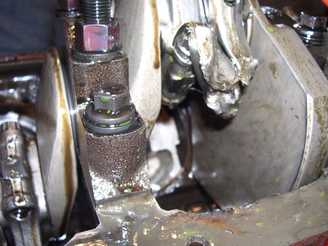

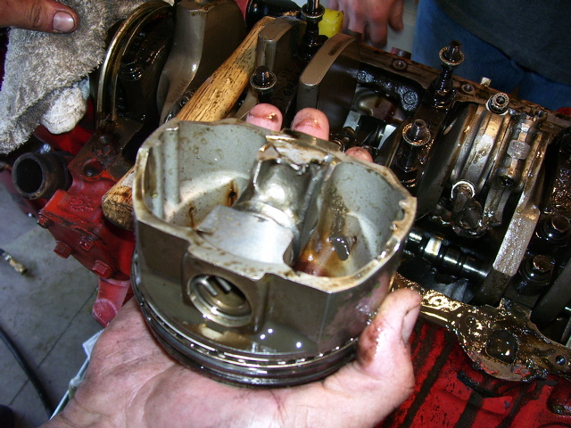

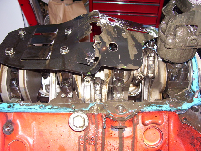

Bottom line was rod failure. The big end was still attached to the crank and the other side was still attached to the piston. You will see it in the pics below.

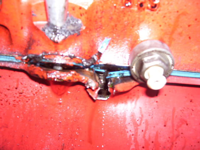

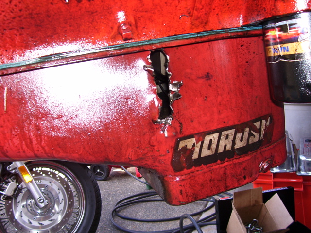

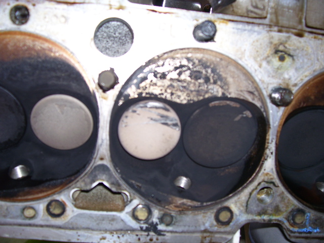

Looks like I bent both valves in that cylinder. The loose rod spinning around smacked holes in the oil pan, ripped through the windage tray and breached the cooling passage on the block.
Less talk, more pics....
We already knew about this
But couldn't see this while it was still in the car

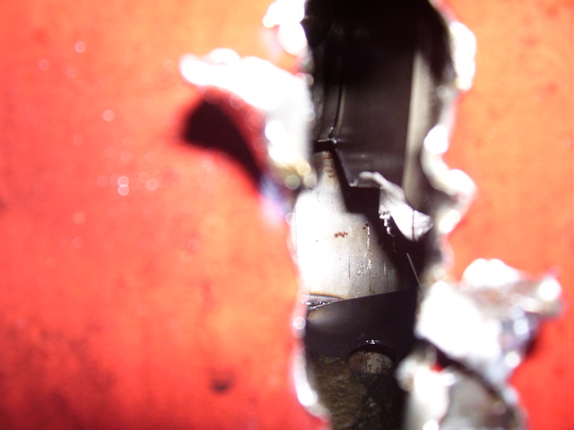

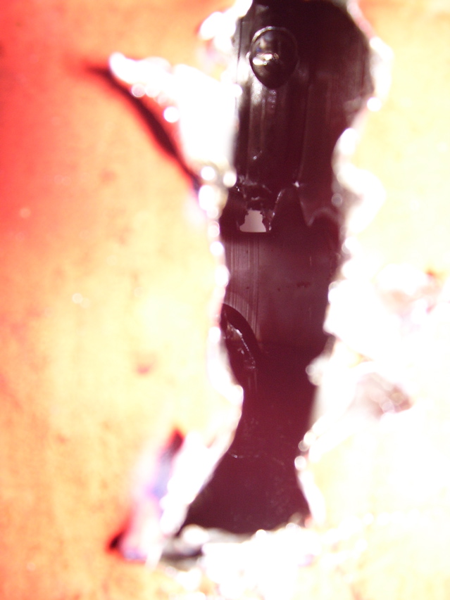

peek-a-boo
Might be hard to see in the pic but if you look just below the crank you can see all the way through the pan and out the other side.

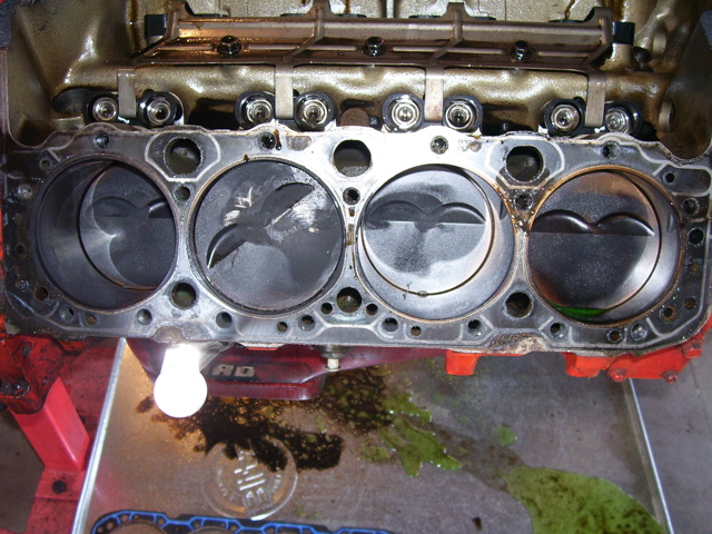

'One of these things is not like the others, one of these things is not quite the same' - I actually have a video of Brandon spinning the piston freely in the hole. You can see the marks from the valves hitting the piston. Those TRW pistons are pretty strong.
Valves that made contact

This is the pic that shows where the rod actually came apart
The rest of the rod tried to wrap itself around the adjacent rod
