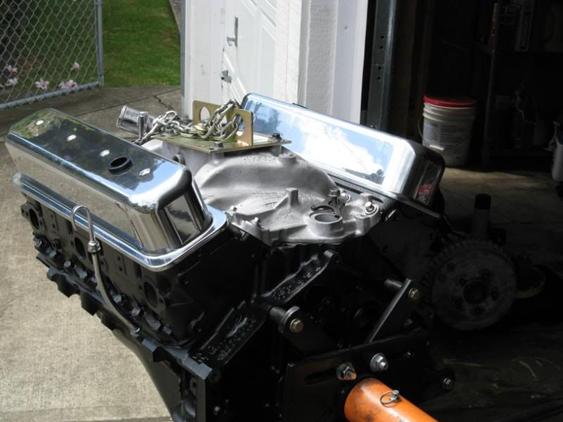

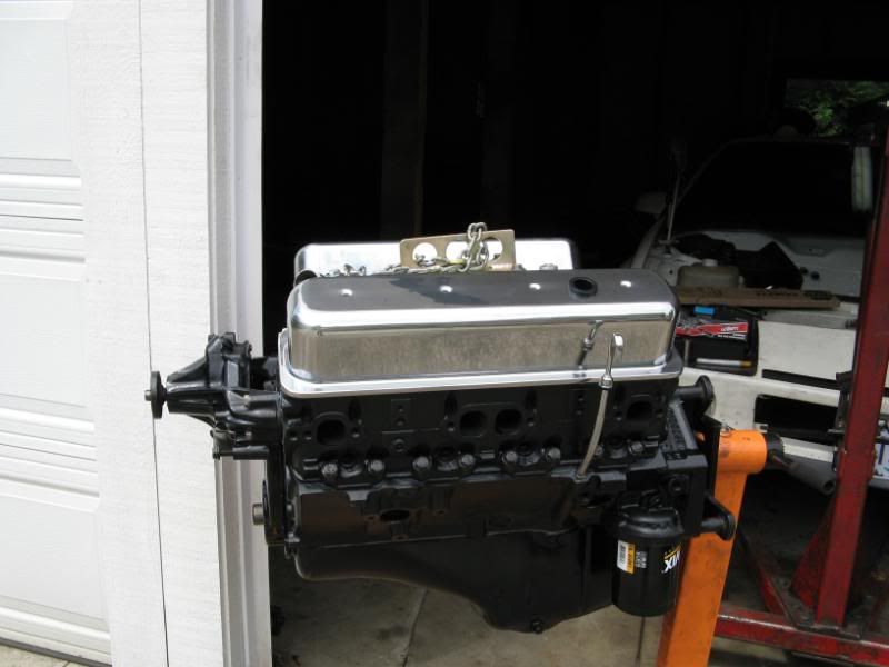

SPECS:
350ci .06 overbore (360ci), SCAT 5140 Forged crank, TRW Forged Aluminum Flattops with 4 Reliefs (+8.65cc), SCAT Forged I-beam rods, Polished and Peened w/ ARP cap screws. Block is .003" decked w/ a .041 gasket, and "187" casting 58cc heads. Cloyes Dual roller timing chain, LUNATI Bracket master cam with a 284AD and a 218 .050 duration. Lift is .458/.458. Cam is retarded 2 degrees.

That's a shiny heap. Thumbs up Think you can get it together by the weekend?
PostPosted: Sat May 24, 2008 8:29 pm    Post subject: Reply with quote
I'm waiting on my Balancer, but short of that, I don't see how I won't be able to get it in and running by next weekend.
PostPosted: Sat May 24, 2008 8:38 pm    Post subject: Reply with quote
Looks good.
Thanks for cleaning my heads up for me. Wink Wink
PostPosted: Sat May 24, 2008 9:20 pm    Post subject: Reply with quote
That's purdy Very Happy
PostPosted: Sat May 24, 2008 10:02 pm    Post subject: Reply with quote
oow thats real nice Very Happy
PostPosted: Sat May 24, 2008 10:56 pm    Post subject: Reply with quote
Good job Chris Thumbs up
PostPosted: Sun May 25, 2008 4:07 pm    Post subject: Reply with quote
Sweet!
