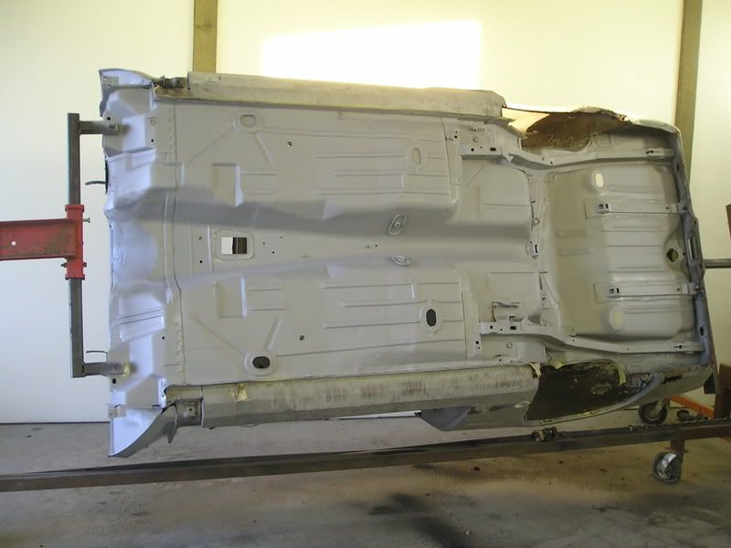

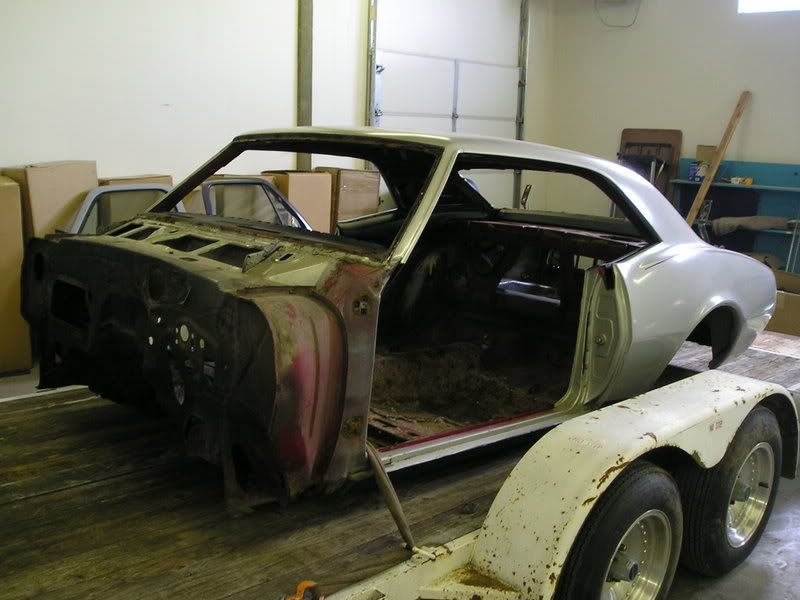

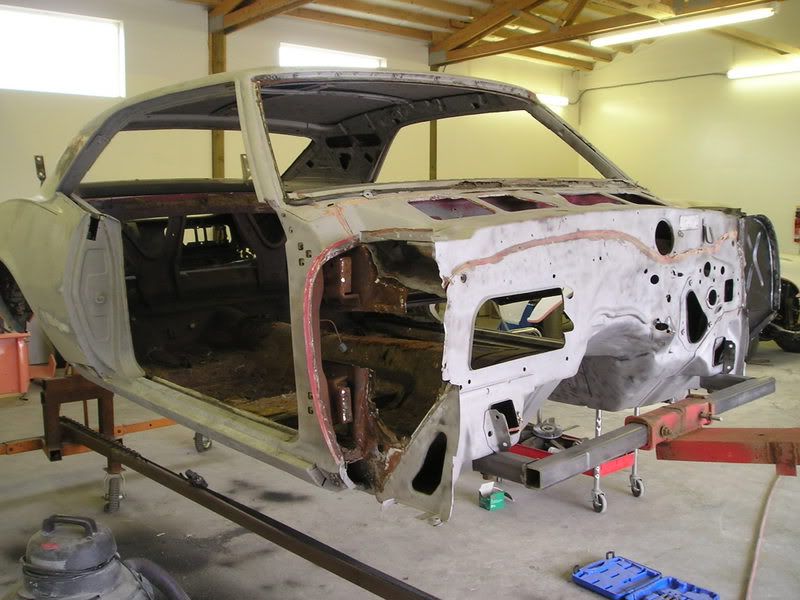

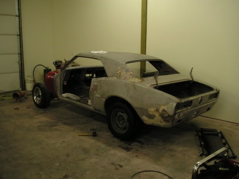

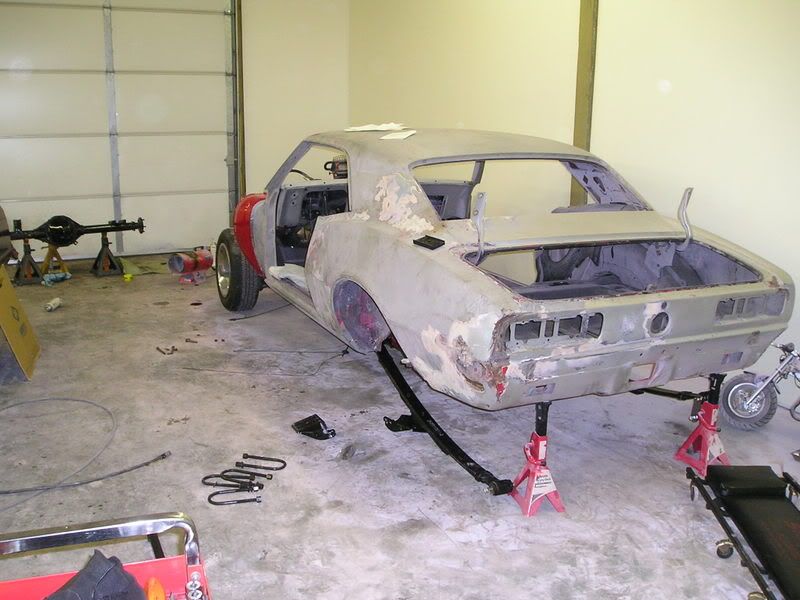

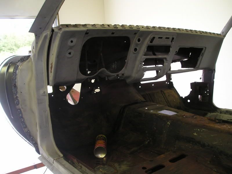

Well as some of you guys know I have begun restoration on my 67 RS/SS everything has been going great! just trying to keep parts coming to continue moving forward. So far I have stripped the car to bare shell put the shell on the Rotisserie and media blasted the whole car. Man was this thing in bad shape! These thing had some pretty bad spots! I have done several things though! Here are some pics!
Removing fenders

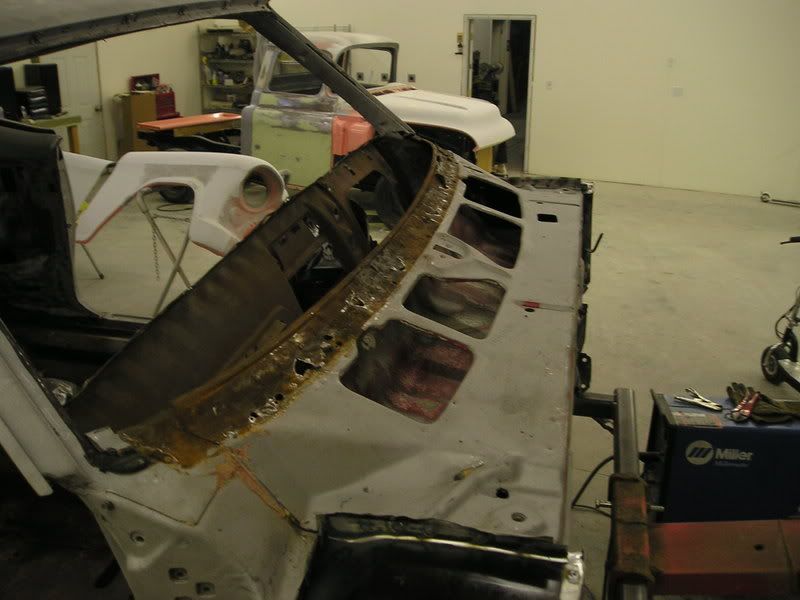

Rust was hiding all over!
After getting the interior removed I found several mouse nests among other very nasty things over the course of the 40 years the car has been around!

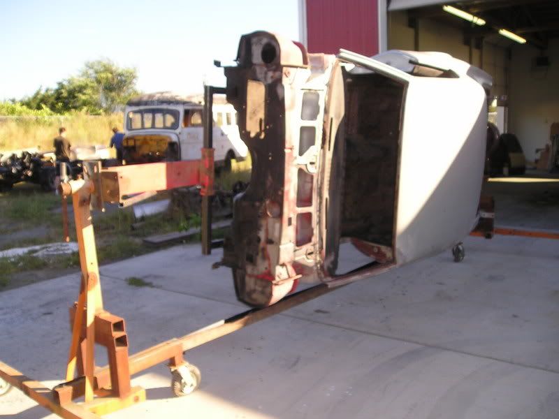

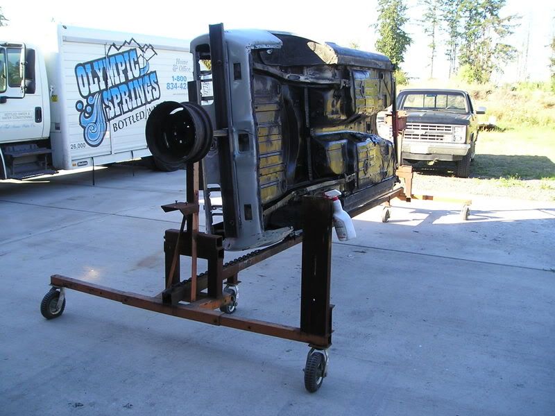

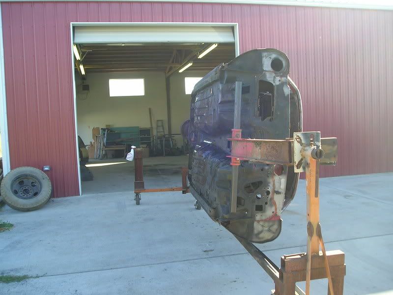

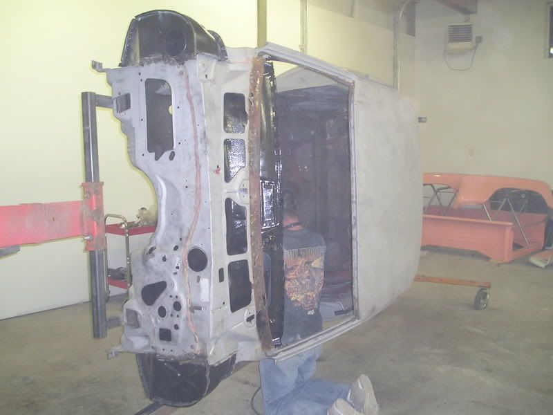

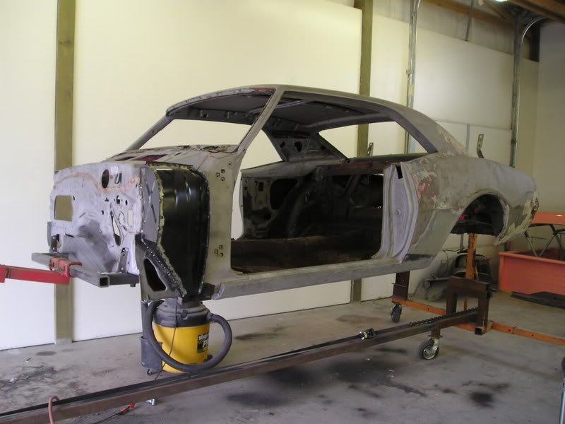

Once totally Disassembled I brought the car to the shop and prepared it for media blasting. It was a chore that took 4 guys to pack the camaro body out of my garage and onto the trailer after that I slinged it with the forklift to get it up in the air while I built the right mounts for the rotisserie to mount to the car.
Now the blasting began! What a PITA!

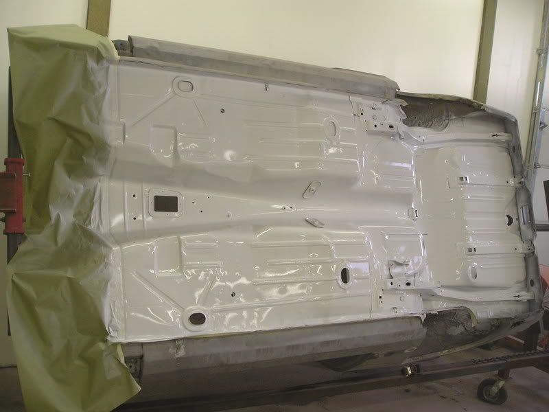

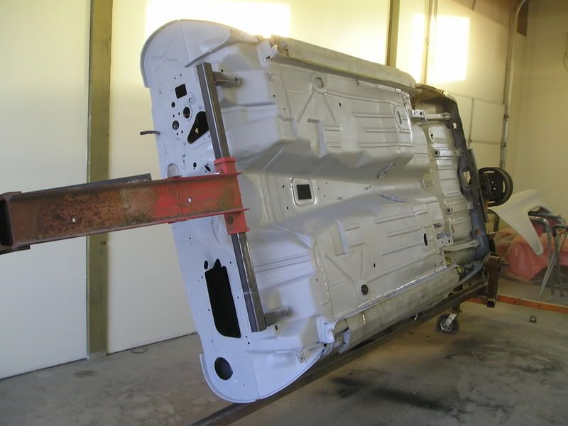

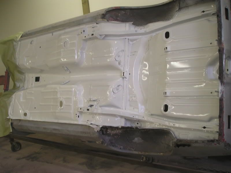

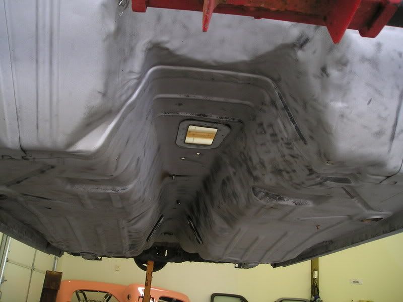

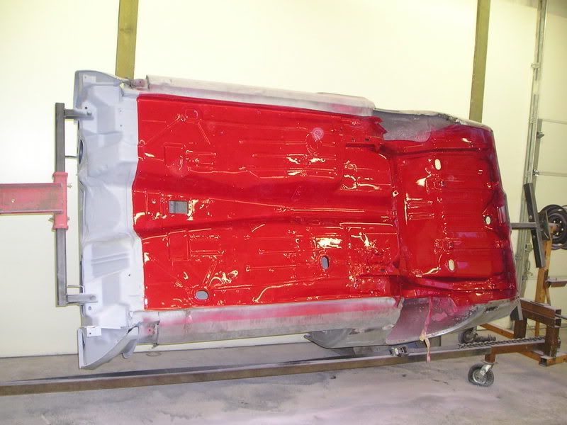

Once the car was blasted I ordered up new complete cowl sides a new dash and rear trunk pan. As well as patched all holes and smoothed the floor. Factory big block car came with a single trac bar that connected to the diff. Mine was broken at the mount to the floor of course because the car had seen a hard life before it came into my possession I reinforced this so the next time I dump the clutch it wont do that to me as well! We then POR 15'd the whole floor.
Tomarrow the car will get all the welds ground down smooth and seam sealer will be applied to the new installed parts and a fresh coat of primer/sealer will go on the whole underside of the car. Once that is laid sometime next week the underside of the car will be painted to match the rest of the car (factory issue Bolero Red)

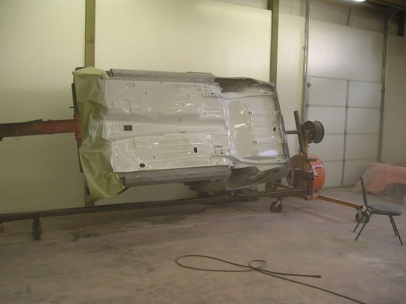

Here are more pics....... As of tomarrow the car should have color on it.
Seam sealed
in primer!

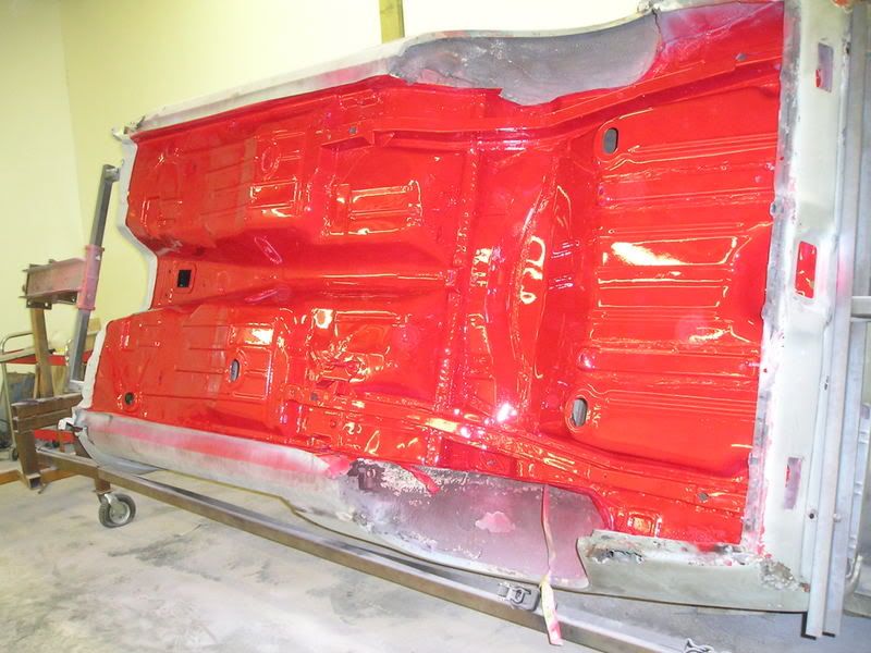

Well the car now has some color on it. I had ordered house of Kolor candy apple red but it looked like crap.... not something I wanted for this project. So that was a ooops.... After shooting some more test panels we decided that the factory red with clear is going to look the best! So here it is! Next will be the firewall and dash. Then I will be getting the front and rear suspension done up and on the car.
Pics with seam sealer/value color
Factory Bolero Red
I can't wait to get the car off that rotisserie and get it back to a roller again! I would do the quarter panels and back half on the stand but after talking with several people they all say that the first gen's need to be on the ground with all the suspension under them before cutting off any of the back sheet metal (besides the trunk) because the body can twist. I will be getting subframe connector shortly and installing those at the same time so that should stiffen the car considerably.

PostPosted: Mon Oct 22, 2007 8:41 am    Post subject: Reply with quote
All cars when hanging sheetmetal should be on the ground with suspension.
