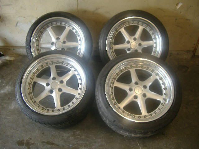

What do you guys think of these? I'd have to run spacers but they are 18x9 and 18x10. Yet another purchase from a nissan site. Kinda cool since we share a common bolt pattern.
http://www.northwestnissans.com/board/showthread.php?t=64216
PostPosted: Thu Nov 15, 2007 11:40 am    Post subject: Reply with quote
Umm, are cars a 5x120.65, those wheels are 5x114.3. Those would fit a mustang very nicely. Wink
If they were the right bolt pattern, they would be good, but they are already on a 5.5" backspacing, like we need for our cars.
PostPosted: Thu Nov 15, 2007 12:00 pm    Post subject: Reply with quote
Oh crap. Are you sure? I thought fbods were 5x4.5, they are actually 5x4.75?
Damn it.
PostPosted: Thu Nov 15, 2007 12:13 pm    Post subject: Reply with quote
Yup ours are 5x4.75, mudstains are 5x4.5
