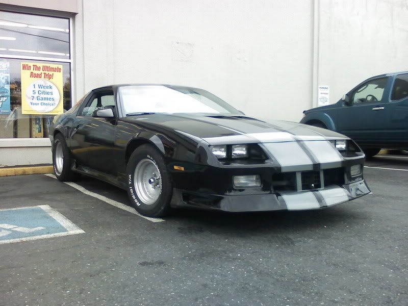

Shocked I run 255/60/15s BF Goodrich Radial T/A's on my back wheels and they are pushing too big. they look cool as hell and give me plenty of grip.
That's what i say you should go for if you are looking for cool big tires. plus you can run whites out and it looks total old school!
STEEL
Joined: 22 May 2007
Posts: 417
PostPosted: Tue Oct 23, 2007 10:25 pm    Post subject: Reply with quote
JAKE! Holy crap that looks hot....
AHHH!!!!!
Ok. Ya, thats what I want. I love your car, I hope i get to see it in person soon.
PostPosted: Tue Oct 23, 2007 10:44 pm    Post subject: Reply with quote
thanks Smile i've put a lot of work into her to get her to that point. I found a better pic that shows off the tires.
The size of tires you can put on a set of wheels all depends on how wide your rim is. I wouldn't want to go any wider that 255 on mine although i can't remember how wide they are Embarassed
PS the tire combo is 255/60/R15 rear and 245/60/R14 fronts on authentic centerlines.
