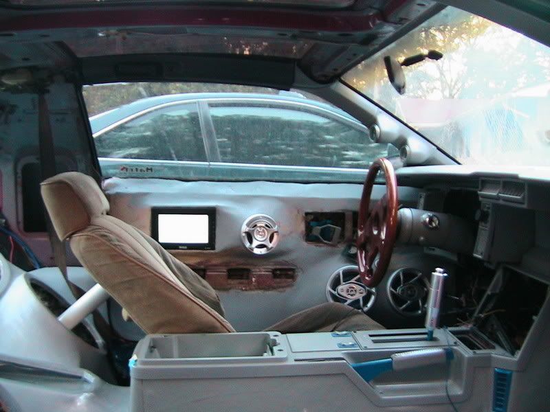

PostPosted: Sat May 05, 2007 12:49 am    Post subject: Reply with quote
not my pic or my car but you can kinda see the roof in this one
