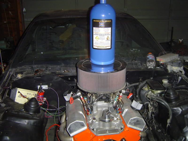

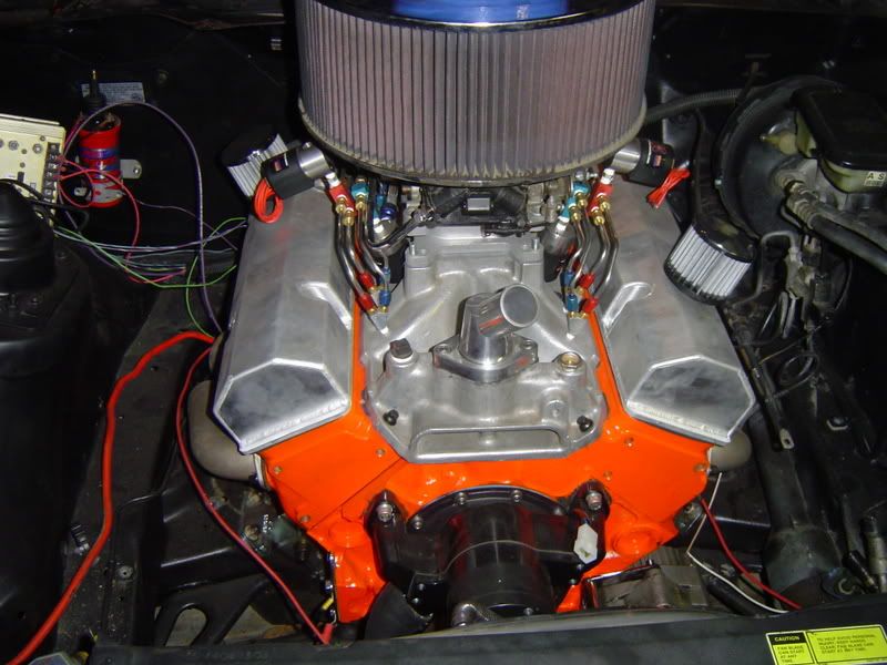

i was board tonight so i took a few pics, i got my hood orderd today glasstek 4in cowl, gotta ditch the stupid tall aircleaner lol, carb sits higher then the cowl screen so i went with the tallest cowl for a firebird i could find. Someday soon it will move again =]
Nathan
ps dont make fun of my dirty car lol
its all about the blue bottle =]
like i said the air cleaner is a tad tall, i had it sitten there lol

its a 383sbc forged eagle crank, forged h beam rods, 11-1 pistons, ported sportman 2 heads, vic jr intake with pro fogger, 850dp holley all the normal arp bolts and crap. th350 3800stall trans brake. hope it will do me good before i blow the thing up with to much spray hehe.

my setup is from 200 to 600hp, we turned it down to 175 just to see how the car goes, engine was built to take up to 450, im probley going to stop it at about 300 or 325hp shot. If i somehow get it to hook and it dont run damn low 10s or high 9s im selling it lol. im hoping to put it on the dyno in the next month or so see what she will make on engine then tune it for the spray that is if it does not just fall apart hehe =]
