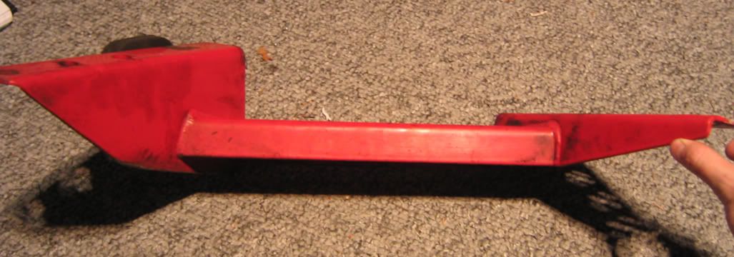

Do you want my old xmember? It's red. Although it's shaved for more clearance and it's got an exhaust bracket welded onto it. Bastards...

It was a spohn unit.
Laughing I just meant the exhaust shop that fabbed up I pipe and tucked up muffler setup. They welded to the xmember without checking with me.
It's a pretty heavy unit. When are you planning on fabbing the thing up? I drive down to Battle Ground every once in awhile. If not within a time frame I can always ship it to you to get some dimensions. You might take this opportunity to get rid of some of the bends in your duals. Run it straight down the tranny tunnel.

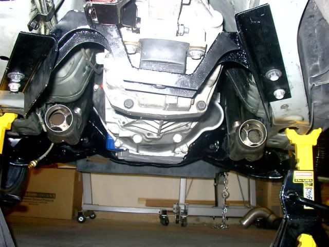

That's a way cracked out cross member! LOL But will locate the trans where it needs to be. Have had problems with vibrations and trans height since I put the TH350 in with the B&M Kit.

That's the one I'm running right now, not the spohn one.
Spohn:
That's looking from the front and that left side came to me about ~2" lower.
