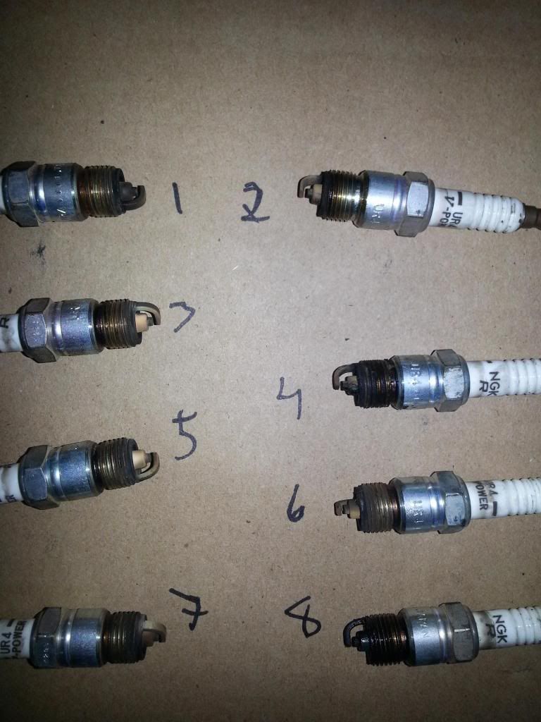

picture is huge but heres a little update, still blows smoke but i decided to do a compression and coolant test, pressurized coolant and it wasnt loosing pressure and i didnt hear any leaks, and i havent noticed a loss of coolant. did compression and got 150psi on all cylinders. cylinder 8's plug was the only one that looked oily, and i have noticed a loss of oil, it leaks, but now that it smokes it goes through more. people on TGO say head gasket but that doesnt make sense because wouldnt i noticed it when i did a compression test? my close mechanic friends say valve stem seals...what do you guys think?

Head gasket isn't going to burn you oil. Oil comes from 3 places on your engine to be burned - Oil Control Rings, Valve Guide/Stem Seal, Crankcase Ventilation.
You have a MAP car, run a breather on the passenger side, and a PVC Valve in the valve cover on the drivers side that goes into the plenum of the intake. If your valve cover DOES NOT have a BAFFLE for the PVC, you will burn extra oil and smoke. Even without the breather, the line on the passenger side should be okay going to the port on the throttlebody. That port should be PRE butterfly meaning it doesn't have any vacuum on that line, allowing that line to pull filtered air from the intake duct, the valve cover, through the engine and out the PVC.
Oil control rings on a newer motor tend to smoke on acceleration, and guides/seals on startup/decal.
If you air filters are dirty, you just stepped on your manhood. Go clean them and get back to us. _________________ A redline a day keeps the carbon away! |

Those plugs looks pretty lousy. Is the fouling on one and four oil or rich mix?
If you and Andy had your engines rebuilt at the same shop and both have leaking valve seals then that may be a thing.

and Aaron i think its from too rich _________________
