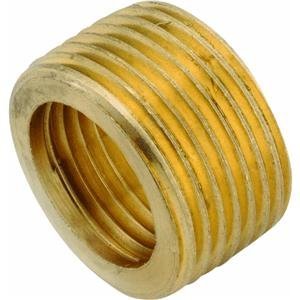

I think I found a spot. There are two, one needs a 1/2" to 3/8" adapter, on top where the CTS should go. How would an adapter affect the reading by the ECM with the probe sitting higher? The other looks ideal for the fan switch, except for it being almost blocked off at its base, just a small hole open to coolant. The fan switch probe fits through that opening just fine, if I mount the CTS there, its probe doesn't quite reach the opening, but would still be surrounded by coolant.

I found and ordered the reducer I was looking for, couldn't find one locally. A face bushing without the hex on top, just a donut with threads inside and out on a tapered diameter. The CTS will go on top by the t-stat housing and the fan switch will go in front horizontally.
The probe on the fan switch fits through that hole fairly well. The face bushing on the CTS will keep the probe lower than an hex reducer will.
