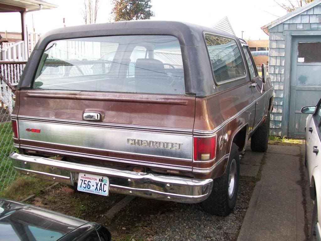

Update: replaced icm with a brand new one. It ran slightly better until twenty mins ago when I was driving it and it completely died. The ses light never went away and it still backfired occasionally under load. According to my scan tool it still is throwing the same code 43...fml _________________ gas brake dip dip |
BluFbdy Member
Joined: 16 Jul 2010 Posts: 915 Location: Port Orchard WA
Posted: Fri Aug 27, 2010 4:04 pm Post subject: |
Okay well we know the icm is good so that leaves the knock sensor, check to make sure its not loose, the wiring going to it is snug and in good shape, I don't. Know how connectors fare up here but when I was in az I was replacing a new one every week from them getting brittle, and last resort swap the sensor, before you do that check your est wire, the brown one you disconnect to adjust your timing, if there is a fault in the wiring there it will pop code 43 and act as if there is a knock, check the whole circuit, maybe its just come unpinned from its plug and isn't getting a good connection _________________ If you expect a kick to the balls and get a slap to the face its still a victory
