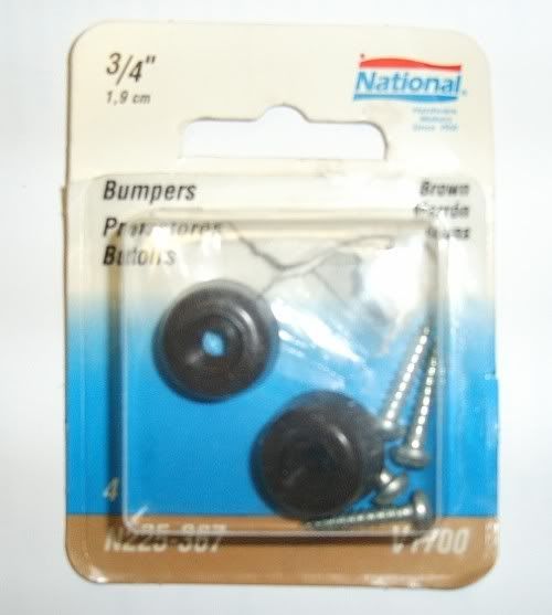

Luckily I had small sheet metal screws holding my sweeps in and not rivets, and they came off pretty easy. You have to roll the window all the way down, and remove the front window track to get at the front screw. Had to redrill two holes in the door for the mounting screws, but wasn't too bad. The biggest problem I saw was when my window went all the way down,, it tucked uner the outer sweep and tried to rip it off when I rolled it up. Turns out there is a rubber bumper that hits the bottom of the door and keeps the window from going down too far that had came off . I went to True Value and got some rubber feet and two 10x24 button head allen screws, and two nylock nuts. Was kind of a pain to drill out the rivet holding the old bump stop mount on, but no big deal.

Get the little furniture bumpers before you start this project. Both of mine were gone. They were 3/4" in diameter and about 1/2" tall, cost about $1.50. You will definately need them. But do the sweeps first before putting the new bump stops on. Without the new bump stops it lets the window go down further so you can get at the screws easier on the sweeps. I tried taking pics of where the stops go, but the pics didn't come out, and the car is back together now. You can easily see where they are........on the back window track. A litttle right angle bracket at the bottom that hits the bottom of the door when the window is rolled down all the way.

Here is a pic of the bumpers I used.
